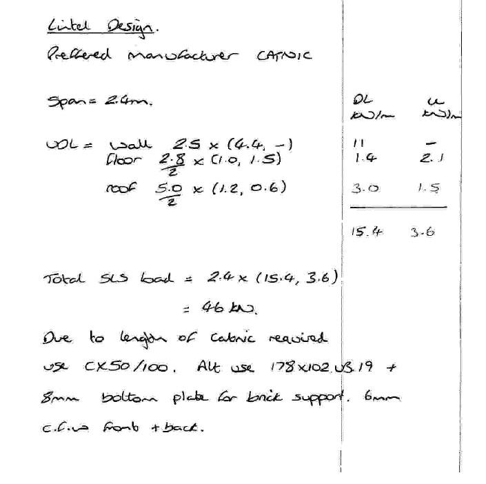

Having found a SE to do some calcs for me they seem to be very different to the 2 'rough' guesses on here.

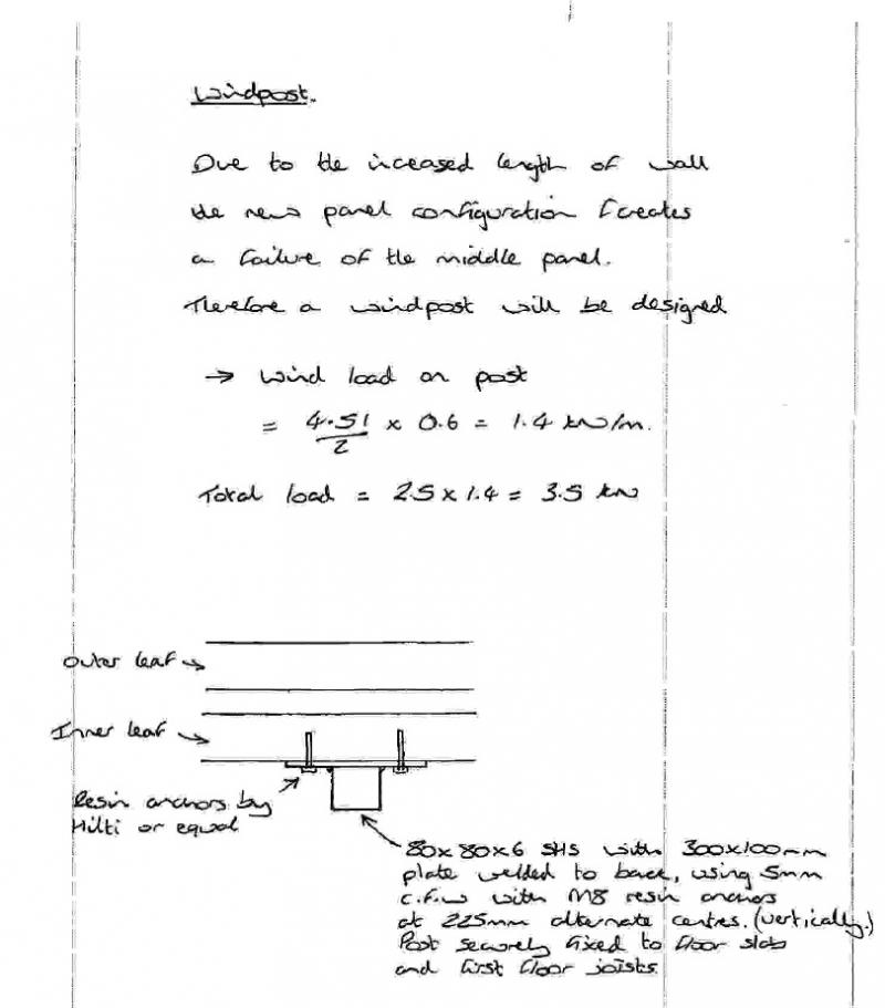

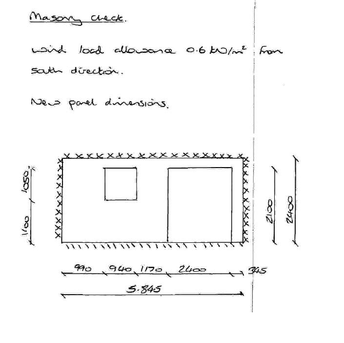

He is quoting 46 kN/m and that the panel to the left of new door will be to weak for the wind and I will need a steel prop on the back of the wall and hold the joist above!
It seems way off the estimates provided here.

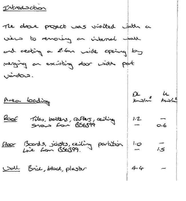

I have a pdf with a lot of info that I don't fully understand.
I have grabbed a couple of screens of the hand written part.
Could anyone shed some light on this please and advise?

Your SE has included a floor load, live loads and factors of safety - which were not mentioned in previous posts.
His figures do seem a very slight bit higher than I use for floor and roof, but not much
Typically for a 3m load in similar situations, it will be just over 40kN/m, so his 44kN (kN/m?) figure is about right
I can't understand the need for a wind post though. Is he being over cautious? I don't know

The figure the SE has given you is not 46kN/m but 46kN over the 2.4m span, which equates to just over 19kN/m. This accords with the rough figures you were given previously. Remember that your SE is in a position to know the lengths of floor/roof/ceiling bearing on the wall; we are not. Also, these things are not an exact science; for example, his choice of dead load for the roof is a little higher than I would use, but that is splitting hairs.
(Woody mentioned 'factored' loads; these are included when designing steel beams and are a way of ensuring an adequate safety margin. It's not clear without seeing all the calcs if your SE has done this. However, when working out the loads for Catnic lintels, Catnic state that the loads are already factored, so you just work out the actual loads without needing to 'factor' them up).
What concerns me just a little is what Woody has also mentioned, and that is the need for a steel post. Your SE has included this because of the narrow bit of brickwork to the right of the existing door. This will be subject to wind load on the side wall and, in theory could crack at mid-height due to the lateral wind pressure. In practice, I very much doubt it would. This bit of brickwork will be subject to considerable dead load from the wall above, which will induce compression into the lower brickwork and reduce the tendency for it to crack under tension. IMO, it should be possible to prove that the brrick pier would be OK without the need for a steel post further along, but the calcs to prove this are tedious and time-consuming. Have a word with your SE, but don't expect him to do too much without being paid!

I have asked him to explain a bit more about the windpost.
It just seems to me that a 80 x 80 steel tube surely can't be much strong than a brick wall that's been standing for 80 odd years!
What I don't fully understand is what is making this panel so 'weak'? Is it the proposed opening shifting the load to that wall or something else?
Looks like he's being cautious to me...where is the calc to prove the wall panel fails under lateral loading?
Also, the new panel size doesn't look to be much different in size than the existing one (although we don't know the exact measurements of the existing panel). Despite the poor flexural strength of masonry, it should be enough to justify the capacity of the new panel by stating that it is similar to the current panel, which has been there for 80 odd years...
Edit
Just checked diagram 14 of Approved Document Part A.
As far as I can tell with a quick check, your wall and openings satisfy all requirements without the need for a wind post.
