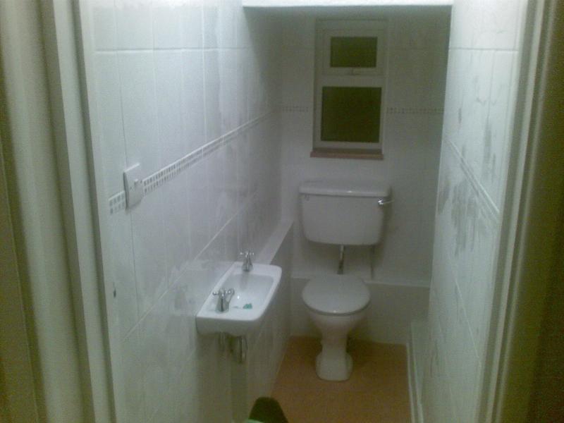

let me first say im a rgi and quite a good plumber and fairly good as most facets of the building trade. However i find tiling infuriating. Ive so far only ever tilled 3 things projects. Firstly a bathsurround around 9 square meters plain bumpy whites took 2 long days, start to finish including strippping of.
Secondly i did a 1200 shower enclosure floor to ceiling including repipping shower removing and replacing shower enclosure bumpy whites with a travertine mosaic border around 9 sq mtrs took 4 days ( day spent flipping the ply boards where the prior person has used floor adhesive on the walls)
And my last job
ooo i hate angles took 5-6 days.
so im half thinking ill pay a tiler to do my bathroom :)
Oh thats under a staircase floor to ceiling just out of shot.
