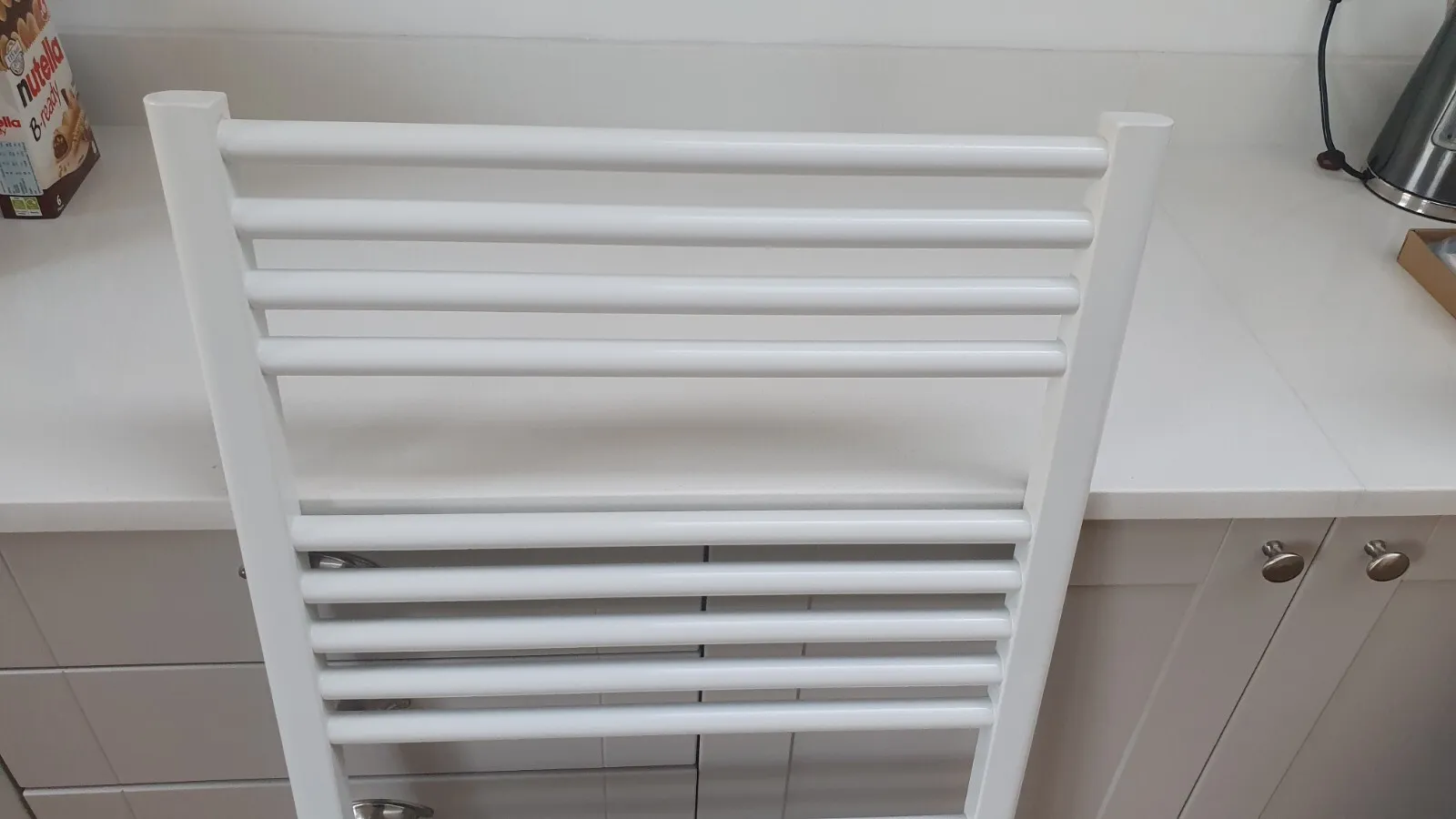

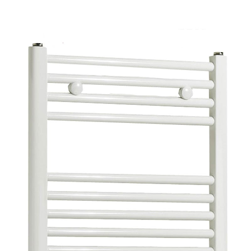

Hi all,
I'm buying a heated towel rail to replace the one in my bathroom. The one in my bathroom runs off the central heating which is two copper pipes underneath. It has two capped nuts at the top end of each frame, one has a bleed valve. So similar to this one in the image.
I noticed the replacement I am buying (below) looks exactly the same, though it does not have the two nuts at the top, it's just blank. It also has a small hole at the top of the frame in the right pic. It does have two pipe holes at the bottom, suggesting it can run off the central heating.
Can anyone tell me what are the difference between these towel racks? Is the hole for fitting the bleed valve in the replacement? cheers
Doesn't the one that you are buying have any description/ technical specifications available to you before you purchase it ?
It would appear to be for a central heating system.
New one has tapping for air vent.
But, where did you buy it?
Never had a rad/rail that didn't come with vent and cap!
Thanks guys, I've not bought it yet, its listed on ebay. It's the only rail that matches my old one, though yeah I can't seem to find one like it online anywhere. I have asked them if they can take pics of the instructions. I still think it could possibly be electric as I've seen ones with holes at the bottom. Maybe that small hole if for the wire? As it would only make sense if it was at the back.

Electric towel rail is much the same as standard usually.
The element pokes up into it from the bottom and other tappings are blanked off.
The wire is molded on to the element... It doesn't go into the rail.
Is this towel rad second hand? The hole at the top should have a vent screw in it for bleeding air out. If its missing, steer well clear.
Yes second hand, but not used. I just saw the instructions and the hole is indeed for a vent screw. I would need to check if it is included. Though if not can these be bought separately?
So I found out it is a 'Dual Energy' towel warmer. Does this mean it can run off the central heating, though also needs electrical hardwire? Or can I just install without the electrical part if it's pretty much has non electrical parts inside?
It depends on the size of the tapping thread. You can buy standard rad vents but need to know the size of the female on the rail being listed.
As I said, mosttowel rails can be either or. Or dual! This is done via valves which go into the bottom of the rail that allow both flow and return water from CH in, and also have an additional entry through which an immersion element can be connected for electric heating.
