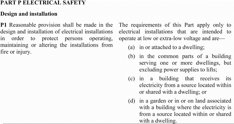

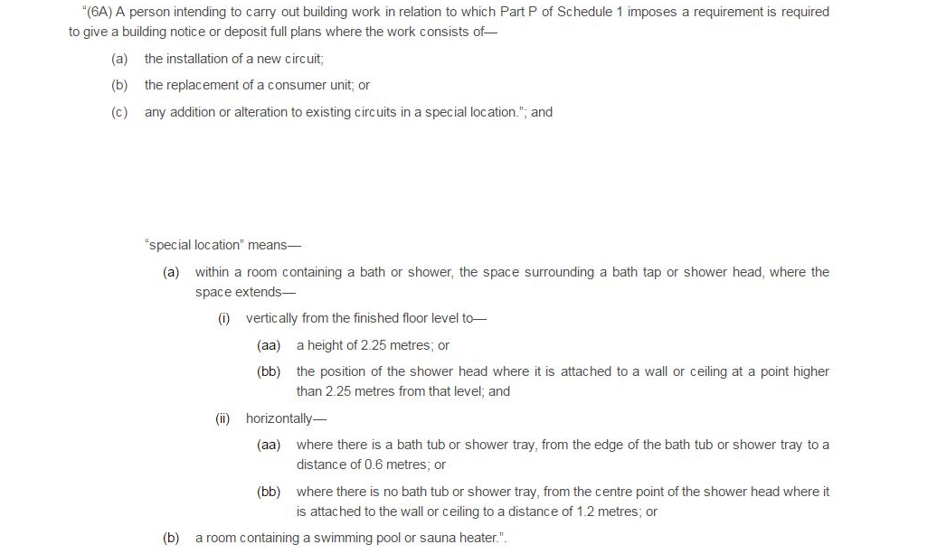

Rather than wade through Approved Document P which is NOT Part P, this is all the actual law regarding notification which states:
With the very short sentence that is Part P itself,
that's all there is.
It is very simple and did not need a book written about it.
that's all there is. ... It is very simple and did not need a book written about it.
