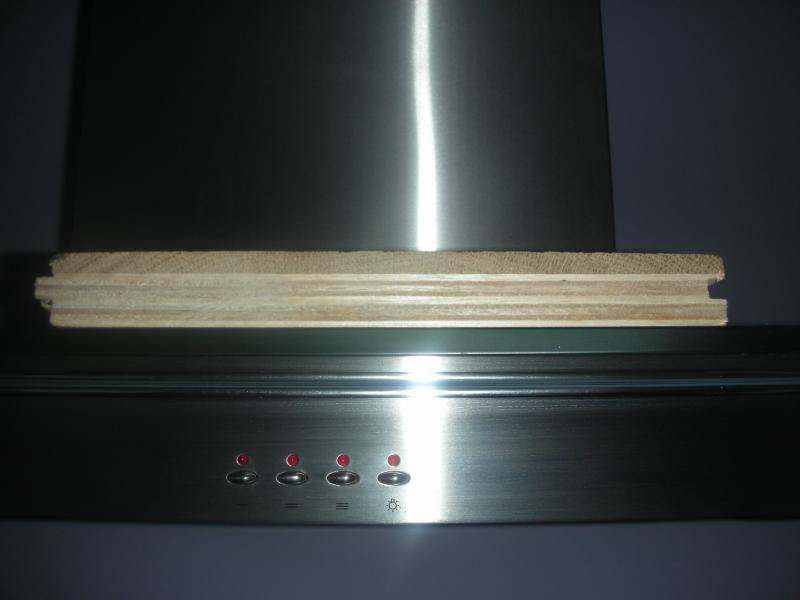

I've just done that with two different samples. Both are intact and there doesn't seem to be any weakness. Is there anything else I should be looking out for? The grain on the face of the brushed and oiled sample has swollen slightly, more so than the lacquered one but I presume that's to be expected?
No, both are rigid. Is that a good sign? What's a better backing, thick layers of ply or softwood and a base of ply? Thanks
That's a good sign. If you mean thick layers of ply the backing has only 4 -5 layers of ply (on a total of 14 - 15mm) then that's not good. The product we use most in this type of flooring has 11 layers of water-resistant-plywood, making it rigid and very stable.
My preferred sample has several layers of ply (I've counted 9 separate layers - can you see it in this photo? It's 15mm of ply and 6mm of oak
The other sample is 4mm oak and 9mm of what looks like one softwood layer and a very thin ply.
The supplier sent me a photo of it installed in his living room and I was a bit put off by the variation in colour. I know it's a natural product and you should expect that, but would that be one of the reasons why it's less expensive? Thanks
I should stay away from the second sample if I were you: compared with the thickness of the top layer the 9mm backing is too thin.
Thanks for all your help, the thick one is my preferred one. The only problem is that it's from a timber merchant in Wales which is a couple of hundred miles away. I'm nervous buying having only seen a small sample but it is by far the sturdiest I've seen for the price.
