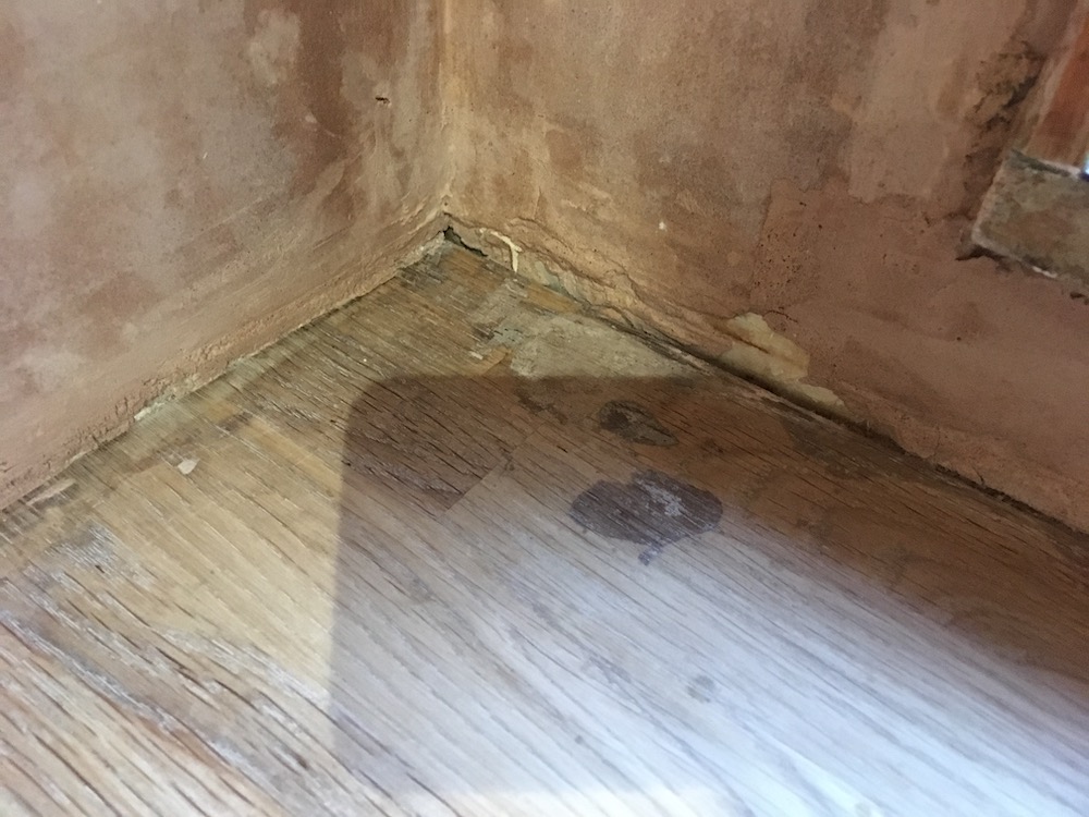

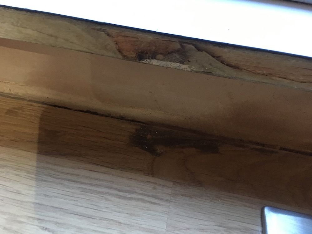

I've had my kitchen plastered recently, and unfortunately the worktop wasn't completely protected, with plaster getting onto the oak worktop.
Some of the stains appear quite light, others darker and I expect deeper into the wood. I've uploaded a video with all of the stains here (with the pointing finger of doom):
The areas right next to the walls will be plastered, so it's mainly the stains which are more than around 1cm from the wall which are of concern.

It’s the water content of the plaster leaving the stain , if you can get heat to the area over tissue it will evaporate the moisture.(tissue will absorb).
Oak that gets wet doesn't dry out cleanly, in my experience, especially plaster or cement stains.:(
