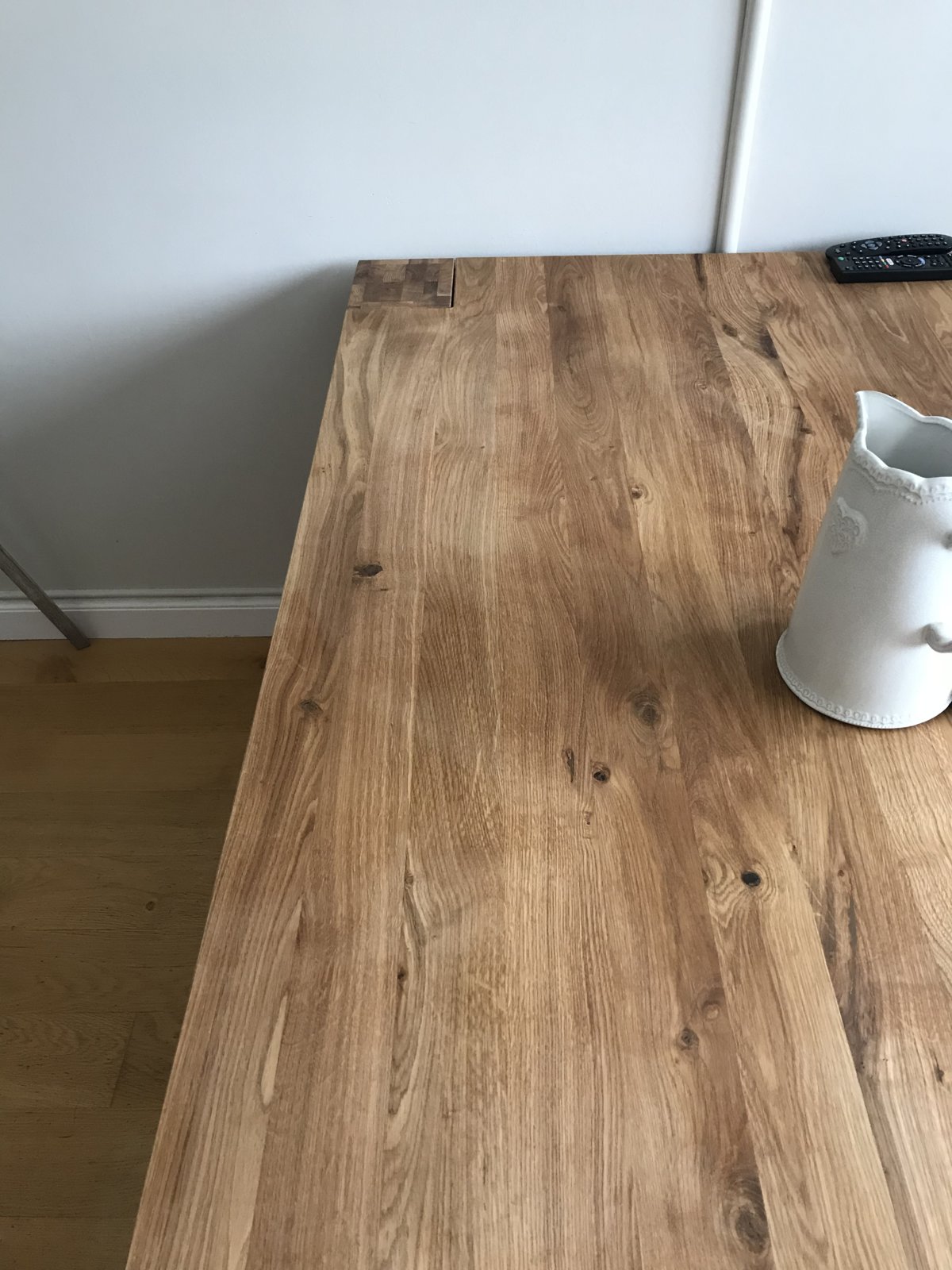

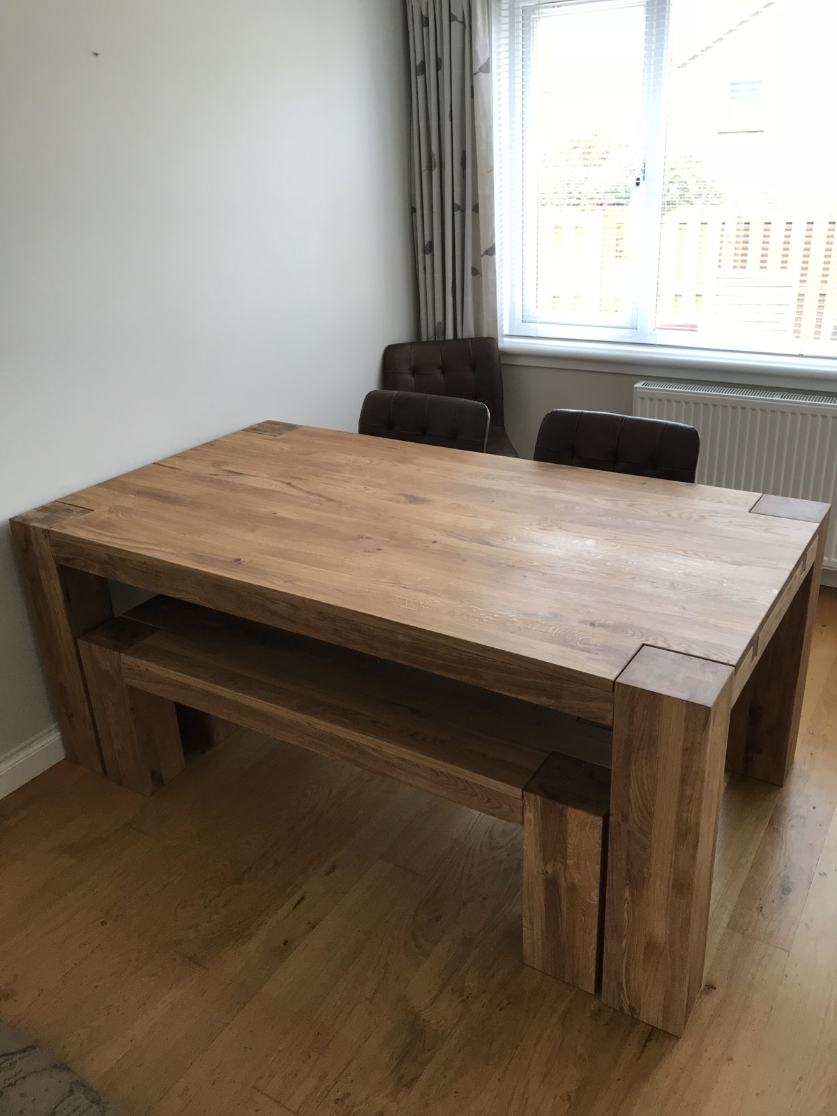

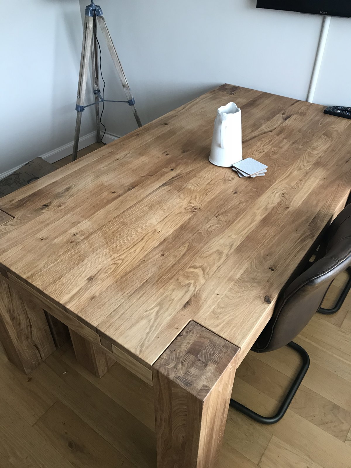

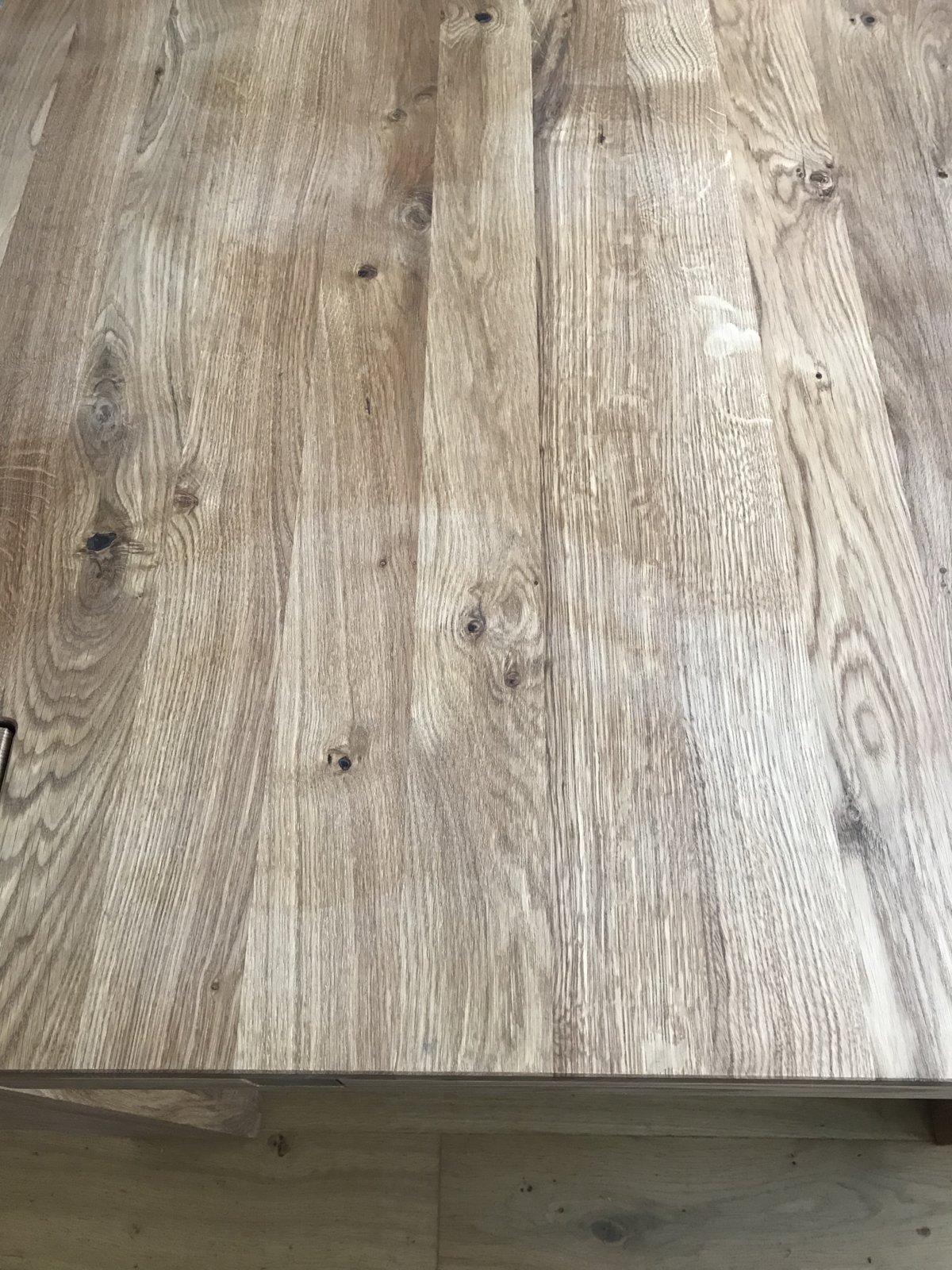

These are the marks

water will raise the grain of unprotected wood, perhaps your damp cloth has done it.
Oak is usually waxed or oiled (or oiled first, then waxed) using several thin coats
The timber in your pic does not look like European oak (which has distinctive medullary rays) perhaps it is a far-east timber. The legs are in the style of some Indian tables I have seen.

Looks like the finish was poor and you have been able to wipe it off, unless the cloth was contaminated with a solvent.?

The finish wasnt waterproof so your damp cloth soaked in and raised the grain.
It needs sanding back and a few coats of oil.
Wont be that easy to eliminate the tide mark though.

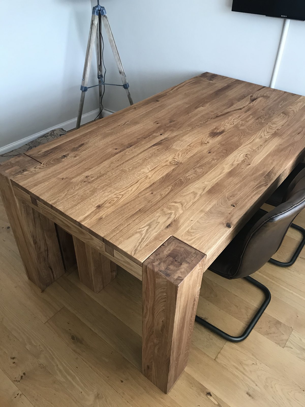

The guys came out gave it a light sand and oil looks brilliant

Looks much better. As long as you're careful not to leave spillages on there and always go with the grain when oiling or waxing it should last many years.
It's not solid oak though, rather multiple lengths of oak butted up together.
Did they leave you a supply of the oil? If so I'd rub (polish) a small quantity of the oil into the table frequently for the next few weeks - say 2 tp 3 months. Did they suggest any polish to use? If not ask.
when applying oil, apply no more than will soak in. After 15 minutes or so, rub with a dry cloth to remove any surplus oil remaining on the surface (otherwise it will go sticky, and be very hard to remove). You have to damp the rag with soapy water and tie it up in a plastic bag before binning, as it is a fire risk and can self-ignite.
Once it's been thoroughly oiled, you can rub it with wax. have a look at the Liberon website, they make some good stuff.
