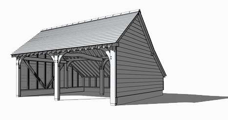

Hi there,
I am attempting to install a slate roof on an oak framed garage that I have had built. Interestingly owing to the shape of the plot the roof is tapered with a width of 5.16m at the rear, 5.77m at the ridge and 6.13m at the front. The roof angle is 40deg. The structure is a double garage a bit like this one http://www.oakgarages.com/site/wp-content/uploads/2011/05/prices_2_bay.jpg but in my case although the front is full width, there is a symmetric taper from the front to the rear of the garage.
I have been reading and searching avidly, but I can't find out the best way to install the 20x10inch slates that I am planning to use. I do have access to 1.5x width slates. I can envisage lots of ways of doing this, but don't know which is the standard method.
My concerns are:
1) how I avoid having narrow slates on the edge of the roof, which my book says are a bad idea.
2) how I avoid water running off the sides of the roof (only a problem on the front section of the roof)
3) how to make it look right.
Any pointers would be appreciated.

overhang the slate 50mm on the verge start slating from the straight side first and use slate and a half on the verges
We used an angled roof trim to create a sort of hidden gutter along the verge of the narrow taper to collect any water run off.
I think the trim was black in colour, GRP and used by flatty installers.

That makes sense. Drawing it all out has helped me make sense of this. The smaller slates (some of them narrower than the regulated 150mm) will be covered by nice big ones, so I guess that means there is no problem.
Regarding hidden guttering, clever idea. I guess there are any number of dry verge solutions that would do this too. I'll find out what my local roofing guys stock.
