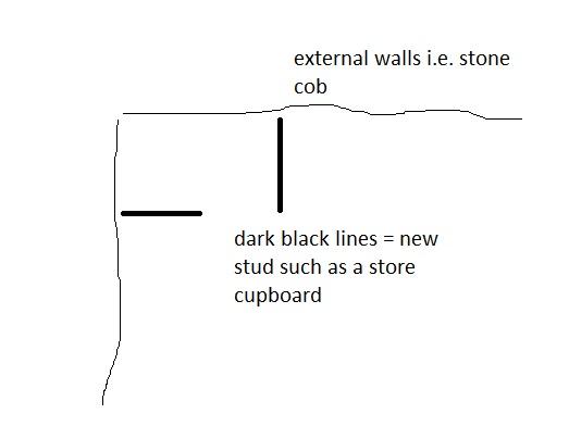

How do you make sure that a stud wall you build out from an existing wall is perfectly perpendicular to it ?
I use a laser level which gives me perfect plumb lines but what it can't tell me is if the line itself is 90 degrees to the wall? So I can build a stud but always at a slightly angle to the wall it is being built off.. How do I find out 90 degree perfect perpendicular lines? And furthermore how do I find it when the wall being built off isn't plumb such as an old stone cob external wall ? Many thanks pros

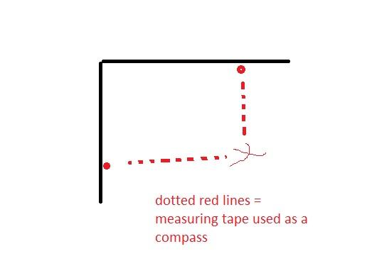

Ok so what I did earlier today was as follows:
1 )Measured how much I wanted the depth and length of store cupboard to be. In this case I wanted 24 inches from the wall and length 30 something inches (I've forgotten) ..
2) Using a laser level I ran a pencil line along the wall from floor to ceiling using a straight edge to mark the line. I did on the faces of both walls.
3) At the base of these lines, I then marked with a cross on the concrete and drilled a small screw at the center of the cross into the concrete.
4) I then used the tape measure to hook onto the head of each screw and swung around making a pencil line on the floor. I did this for both lines and made an intersection on the floor with a pencil.
5) Using the laser level, I then lined up the existing lines marked on the wall with the intersection point on the floor and removed the two screws.
6) Using a straight edge, I marked the ceiling and floor along the laser line
7) I then screwed the ceiling plate and then the sole plate, fitting it with frame fixings
8) I then fitted my upstands using the laser level to make sure that each was perfectly plumb.
9) To check the corner, I used a carpenters square to make sure - and it was spot on.
I'm going to re-read this thread carefully now and make absolute sense of you guys methods

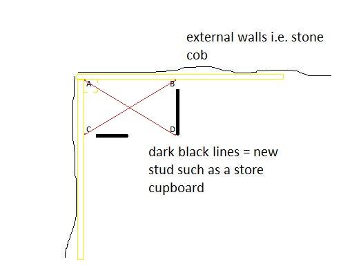

Lay a straight edge (yellow) close to wall at corner and mark a line A-B.
Lay a straight edge close to adjacent wall, use a square to make perpendicular to A-B and mark a line A-C.
Mark point D so that A-D = B-C, and check by measurement that A-C = B-D and A-B = C-D
Mark lines C-D and B-D
