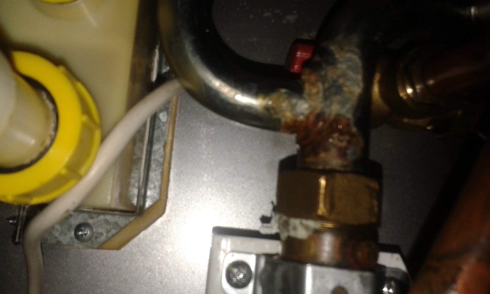

I am looking for a boiler part that is obsolete :
Return pipe part no S801048 for a Glow worm energy saving combi GC 2 80 47 047 13, model no 801091.
British Gas have said they can’t fix my 80 year old mum’s boiler without it. I’ve discovered the boiler has been dripping for months (floorboards soaked when I lifted the carpet), and BGas didn’t even notice when they came to do the annual service in October. All round unhelpful and taking money off an old lady for several decades without taking appropriate responsibility.
Anyway, rant aside, any help appreciated. I have done the obvious things of searching online, phoning places (including Glow worm). Just hoping someone has one hidden in a stock room somewhere!
Thank you

A further question : before the BGas engineer poked around, the drip was very slight (around a tablespoon of water in 18 hours. Now it is a much faster drip (a mug full in 12 hours). Can leaky pipes like this be sealed/repaired? Is it worth getting an independent engineer in to have a look?

Aren't these a weird layout on the pipes with an extracted tee brazed into the return pipe just inside the casing?

Thank you both. Does this pic help? You can see where the drip is forming. Dan, are you saying this is fixable without replacing the pipe? It is far clearer in this photo how corroded it is than when I just look at it. I feel even more cross now that it was not picked up earlier.

That looks to me like the brazing on the tee joint has failed, if you can get the pipe off, it may be repairable by an old school engineer who can braze, but chances are the metal in worn very thin, hence the pinhole, and the only viable repair would be to replace the pipe.
Sadly I suspect, if you cant get one, its new Boiler time. If you need someone to quote, put your location, sometimes one an installer from the Forum is local and will be happy to help.
