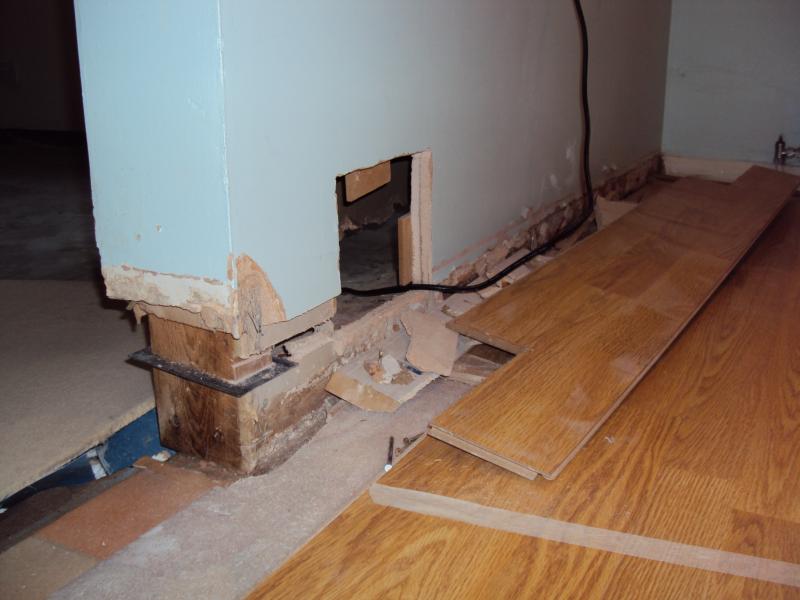

The damp patches are either side of an internal wall 'archway'. One side is a false wall (plasterboard both sides with 6-8 gap inbetween) the other side is solid brick with plaster covering it. Both internal walls. All outside walls appear dry. The picture was taken last year when we took everything apart - and replaced the floor and all the central heating pipes, and even put a piece of plastic into the wooden strut on the left to stop any damp from rising. The problem is exactly the same now as it was then! (I hope I have enclosed the photo OK but will try again if not!).
Picture 1) is general showing both sides of the arch - it is wet on the right side of the arch but not as bad, but not sure if you can see it on the photo

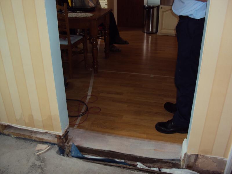

Picture 2) - from the kitchen side (this side does not appear damp) - but shows the structure of the wall. We put the plastic piece in between the wood to stop the water rising, but since this has not stopped it - maybe it is not rising after all!

On the LH wall paper side, the studs/posts are not set on a plate, & appear to go below the concrete into the, presumably, sub-soil.
They might be pulling up some moisture. Which would account for the "tide marks" on the wall paper.
Something similar might be taking place on the brickwork side of the arch.
The laminated side floor doesn't appear to have a membrane?

Thank you for your reply. The pictures here were taken last year when we had everything apart and we thought we had resolved this. it is all fully restored currently but the water marks are still appearing.
The wooden stud/posts - seem to have been built on top of one of the original brick walls of the house. They did not appear to go into the soils when we excavated the area.
The laminated floor side (kitchen) is a later extension and this it is a concrete floor about 8 inches deep and it does have a membrane underneath it which we found when we were replacing all the central heating pipes.
The second picture (blue walls) shows a close up of the wall structure as best as I can show it now, as it has been re plastered over now. Hopefully if you look closely at the wooden upright strut - we cut through the timber and inserted a piece of plastic horizontally that was intended to stop any moisture rising up the wooden strut. But this has not stopped the moisture problem - which still appears exactly as before.

If you were able to cut and slide a piece of damp into a bearing stud/post, then that stud had very little load on it, so, presumably, the partition is not load bearing.
FWIW, your remedial measure is almost worthless.
The root cause, i would suggest, is capillary action (rising damp) from the old, below the concrete, brickwork.
Partition/studwork bottom plates should sit on the concrete surface not go below it.
Whoever originally built the partition and/or poured the floors should have been alert to this capillary possibility.
One remedial option would be to sand and lime and cement, semi-tank the walls to a height of 1m. This would give you a 20 year damp/stain free breathing space - however, decay would continue in the walls to any wood members.
Another option would be to open it all up, & cut out all below concrete FFL, make good & rebuild a new, say, 1m high frame.
