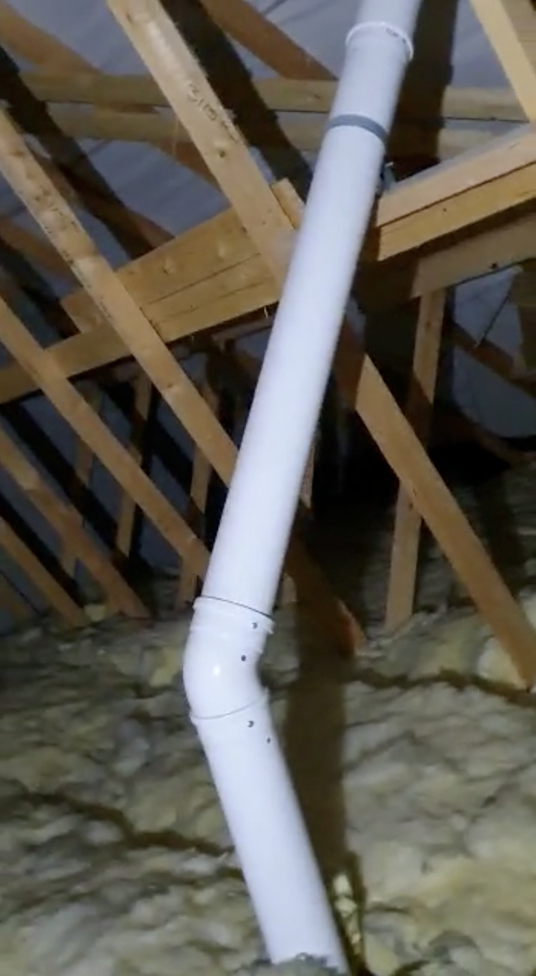

Not sure about this. The boiler is in the middle of the house. The only large pipe coming from the boiler goes straight to the roof. I actually tried to locate the soil stack but couldn't see anything. I've attached a zip file containing a video of the loft space. I don't know much about this (obvs), but I expected to see something that looks like a soil stack, but nothing.

That'll be the flue. If the boiler is aged it won't have a condensate pipe- you need to look for a 30 or 40 mm pipe, usually plastic, going downhill from the boiler.
