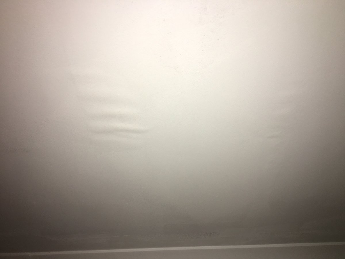

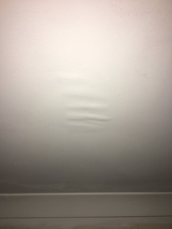

I've just had 2 rooms plastered in one room after applying a mist coat the plaster has blistered in a sound wave pattern in a small area of the ceiling. Please see the picture.
I have used the same paint in both rooms so assume it's not the paint. When I rollered this area of the ceiling it did make a sort of flex noise like something was loose when I applied the roller.
I left the plaster for 10 days before painting.
Any idea what ha cause this and how best to resolve it?

Adam,,, it looks to me as if it is plaster that has blistered. "Gently" rub the back of your hand/fingernails over the area, and you'll soon hear if it is hollow underneath. Do that over other areas of the ceiling too. If it is hollow etc, get your plasterer back.
Depends to some extent on what you were plastering/skimming onto? And what the finish was and how it was mixed?
Pic 2. shows an irregular, grainy, rough surface - IOW's its been badly skimmed.
Perhaps a more detailed preparation was needed?
Thanks. They skimmed new plasterboard so I guess bad prep.
The plaster is coming round tomorrow so will see what he says
I've perhaps seem similar with thin plaster at the edges when feathering/patching on existing skim. A roller especially has cause blistering when painting after - seems to soak it more with paint and the suction pulls harder at the surface than using a brush.
I've certainly not had a problem with skim on new boards.
See what plasterer says.
The paper may have come away from the plaster board before it was put up and when it was skimmed it may have caused the "bubbles". It's just a thought!! But you can get a sharp blade and gently cut around the bubbled areas and maybe skim it with a bit of easi-fill and when it has gone off sand it lightly till it is level with the surrounding board and paint over it and you may have to rub it down a bit more when the paint has dried and maybe put another coat of easi-fill and rub that down, When its dry paint the whole wall again and it should blend back in.
