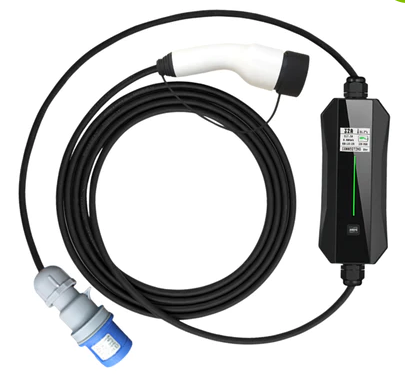

In theory I could fit a commando socket and use one of these 1672047996076.pngthey are for sale from UK sites as long as I say the 32 amp socket is for a welding set not an EV charger I can have one fitted by a scheme member. Or use an existing supply in my integral garage, not that I would want an EV parked under my house with the fire risk.
However I would be breaking the rules plugging an EV into the supply, in same way as I can buy a drone or radio transmitter without a licence you can buy EV charging kit, but that does not mean you can use it, be it an electric scooter or EV charging point, being able to buy them, does not mean you can use them within the law.
