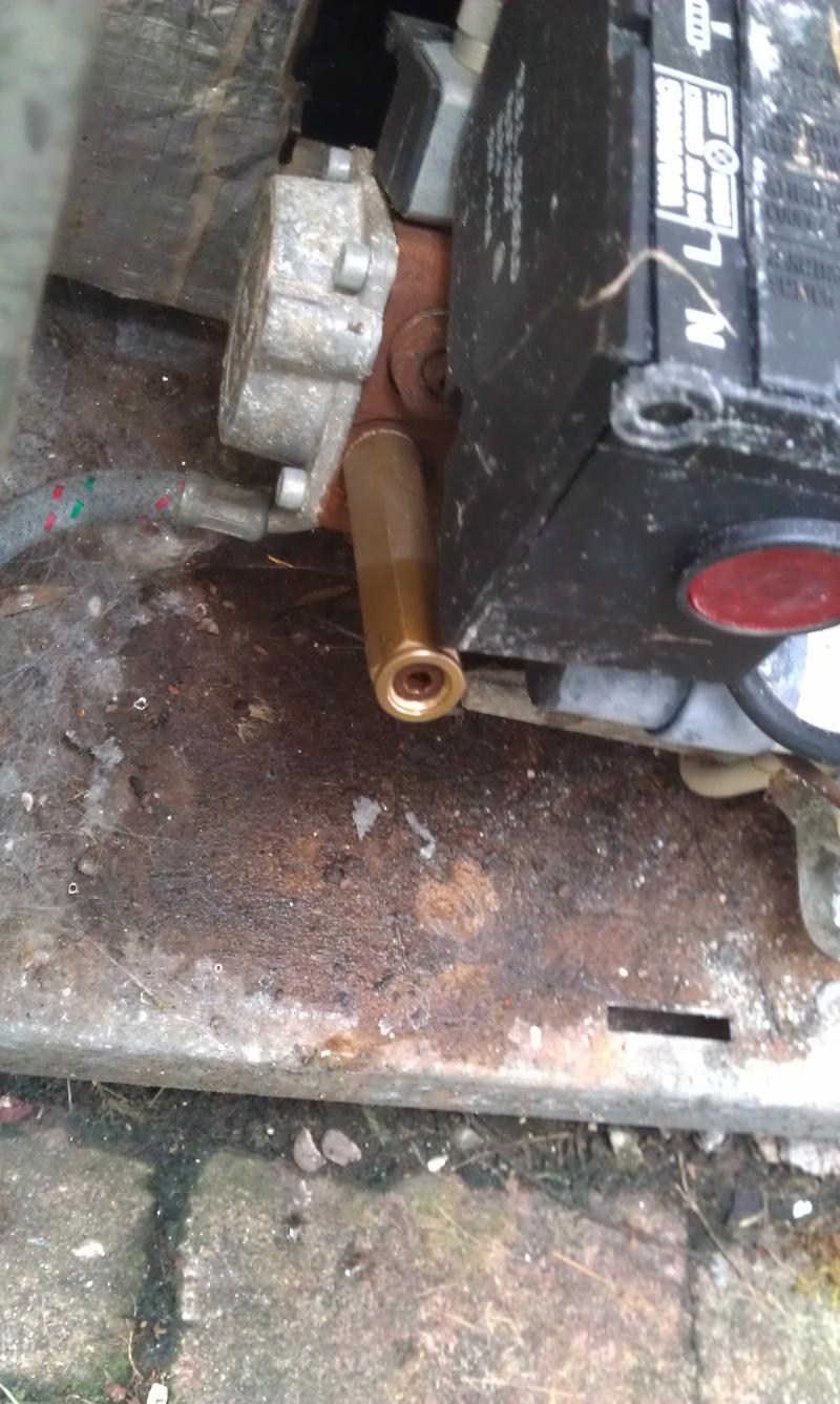

Our boiler is poorly maintained and has not been serviced in years. It is an outside oil burner and because we are short of money I have to bleed it every time the oil runs out, using the red button to fire it up. I realise this is BAD, my partner disagreed to any expense in maintaining it.
The problem is that after thee last time we got oil it was fine for a week, then all went dead. I went outside to press the red button, thinking I might need to bleed an airlock, but the red button now does nothing and it does not fire up.
I have an electronic systems engineering degree from 20 years ago, but know little of home heating. I am going to get someone in, but before I do I want to get some advice. There are a lot of cowboys out there and we are desperately short of money, so need to get this done as cheap as possible. Within reason though - I do not want to have a cheap and dangerous solution.
I have checked the electricity supply to the box, which contains two normal AC power circuits with something plugged in to each. The supply to there is fine.
I have removed the black cover to press the small white reset switch, that does nothing.
There are TWO internal thermostats, one upstairs and one downstairs. Fiddling with them makes no difference. The controller is a Centaurplus C27 and appears to function normally.
As the boiler is not firing, I assume the problem is there.

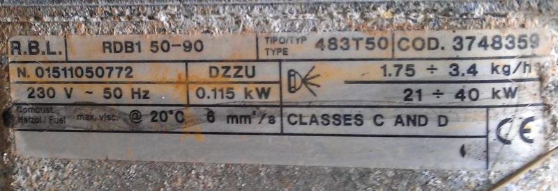

I am unsure of the EXACT model name for the burner, but have included a photo of it's label.
Could someone advise of potential faults (if that's feasable) and maybe take a guess at what expense we are looking at? Any help with how to choose a good tradesman would be helpful too. I see some listed with a OF(something) qualification but not sure this will mean more money or not.

That outdoor boiler is in dire need of some TLC. Lot of corrosion round oil pump, under burner and looks like the alu shell beside the control box. When was it serviced last?
Boiler dead could be several things, OH stat tripped, bearings gone on pump and/or burner motor so jammed. Water in oil line causing failure of pump. Control box failure.
Its a Reillo RDB burner so parts readily available but cannot diagnose from pictures.
Look at the OFTEC site for recommended service repairs>
Is it possible that constantly running oil has just been putting grit into the burner?
How much does a new burner cost, and the pipe on top that is corroded/ (Roughly speaking, even within an order of magnitude - we are looking at the bank balance and thinking we might have to go the winter without any heat. £150 a month on oil has been killing us).
Expect to pay around £325 to £400 for a new burner - which comes complete with control box etc.....it will need commissioning though!
However, if the burner lock out lamp is not lit, then you could be looking at mains supply failure, thermostats tripped (manual type), seized motor, dud start capacitor or pump, etc.
There is a gauze filter inside the pump front cover should you wish to check it, and all bits are available for Riello stuff.
That thing needs a full strip down and every part tested.....!
