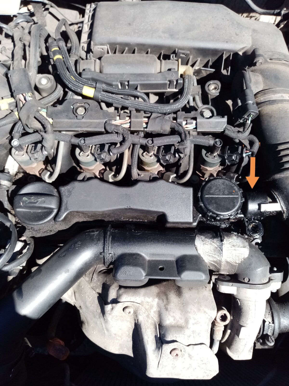

Old peugeot engine has an oil leak.
Anyone any idea of what is causing it
It looks like a 1.6 hdi engine?
The leak could be from the breather at that end, a faulty rocker cover gasket or indeed a cracked rocker cover itself.
A bit more cleaning up and investigation needed!
John
I have the 2.0 HDi, and had a leaking rocker box cover gasket. Swapped it over for a new one and cleaned up and not seen any leaking oil since (in that area...)
