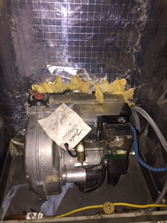

When our oil boiler is switched off a strong smell of unburnt heating oil fills the utility room where it is installed. This is noticeable after a few hours and is unbearable when we return after a weekend away.The smell disappears when the boiler runs for any length of time. The floor of the boiler is perfectly dry and I've lined with tissue paper when off to identify any small seapage but nothing observed. The smell that is created contaminates any laundry in the room. Any ideas on how to cure the invisible leak?
It'll need opening up to further investigate, could be coming from a few places. When was it last serviced ?
It's a Worcester Danes-moor 26/32. Balanced Flue. Fully serviced 6 months ago. Runs clean. Opened yesterday and looks spotless.

Have you taken the boiler top off yet Craig? There should be a drip tray under the burner and if I remember the pump is on the right side of the burner - is that correct? BFP 11 pump, Sterling 50 burner pointing downwards.

Edit....that looks like an Inter B11 burner - I was expecting a Sterling 40 :mad:

If you can see no trace, then the pump shaft seal is a prime candidate. You need to remove the pump from the back of the motor to check this. There could also be seepage into the combustion chamber. This is not a balanced flue, just horizontal. The burner would be in an enclosed box if balanced flue.
Another item to check is the fusible head isolation valve. These often leak up the valve stem and the wet can be contained in the head. Remove the wheel, turn clockwise and the wheel comes off, it is a left hand thread. You may find a slight leak there. Often this leak can evaporate in use.
