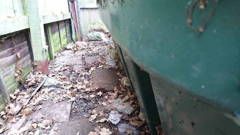

I have a Balmoral BRMH2500 (this size was recommended by the boiler installer) single skin oil tank that was purchased in December 1994 and installed shortly after (along with full central heating system). I believe Balmoral are no longer trading.
Early today I found that there was oil leaking from the large band that goes around the tank. Closer inspection showed a small pin prick. I called out a repair company I found with Google and because they were able to get to me within 2 hours I went with them qwithout trying anyone else. They have pumped out approx 1700 litres into temporary storage tanks (at a cost of £350+VAT each) so that the oil level is below the leak. They couldn't leave the tanks as there was nowhere safe to do so and have taken them to their yard marked with my name and quantities.
The company concerned only install Atlas tank and say I have to have a new bunded tank not single skin. I have checked a couple of sites and as far as I can tell I don't meet any requirement to need a bunded tank.
I don't actually use 2500 litres per year, my usage is nearer 1900 litres. As an example my 3 latest deliveries were 17/8/15 900 litres, 6/1/16 600 litres and 15/6/16 11 litres (yes I have just topped up). With each delivery the tank was more or less full.
I have a few questions:
a) Can the Balmoral be repaired aqnd if so how and is it worth it?
b) If I keep below 2500 litres do I really need a bunded tank. My wife and I are both in our mid seventiesand as the Balmoral lasted over 22 years a single skin, if it gave the same life, would outlast us.
c) The company concerned only install Atlas tanks and I think their recommendation will be the Atlas 2500 BHA which as far as I can is is about £1400 incl VAT to which must be added labour etc. The guys that pumped out my tank were saying that would have to lay some slabs or something on the base as my tank is pitched forward and modern tanks need to be pitched back.
d) If I were to decide to go with another installer would I be right in thinking they would charge me for bringing back my oil and pumping it into my new tank.
e) As I will have some oil in the tank, approx 500 litres, this would have to be pumped to a temporary tank, it would be galling to have to pay another £350 just to have the old tank emptied before installation of the new. Is this normal??
f) If I want a smaller tank, to reduce cost, this could be pumped to my neighbour but again I suspect they would probably charge.
Thoughts and advice please???
