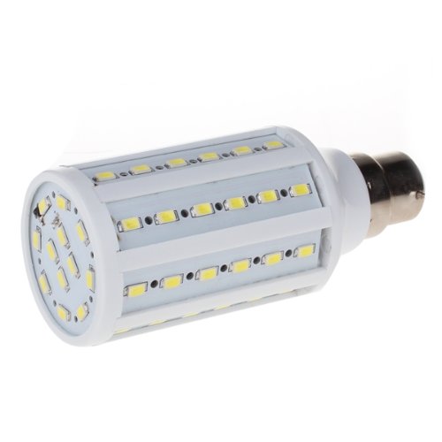

This is an example of lights with live parts which can be touched. With GU10 even worse as no polarity.
It would seem some of the cheap devices do not have little transformers but use resistors and capacitors to reduce voltage and these are inserted on one leg only.
Loads of videos showing tests on these bulbs it seems this
is used so with any lamp always switch off first.
