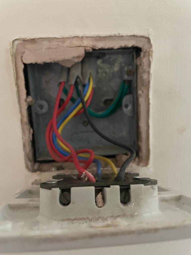

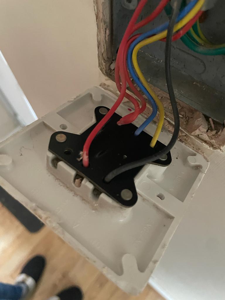

Hi
I have this lighting socket but it has no markings, does anyone have any idea what is L1,L2 and Com
Many thanks
J

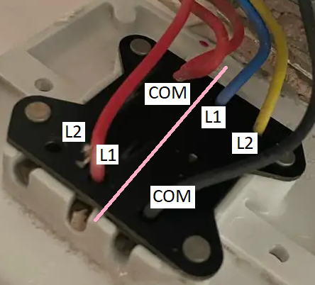

...and if you wish to replace the switch, they are generally known as "2 gang, 2 way" light switches.
That is great … thank you for everyone’s help with this
