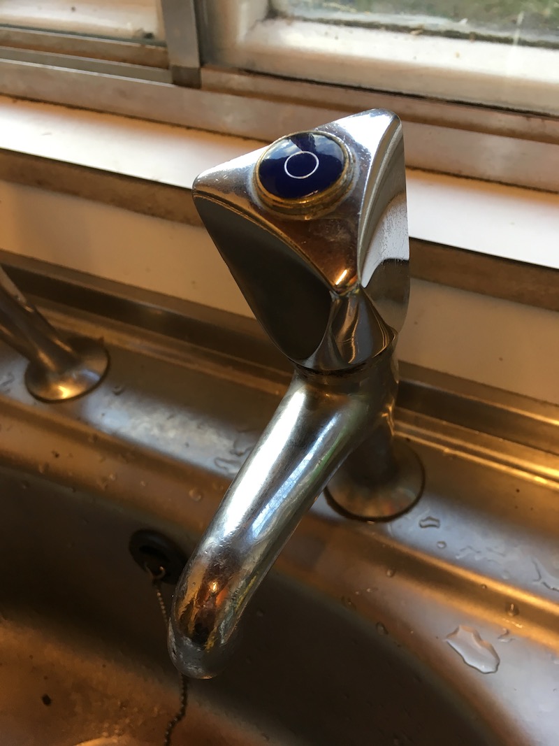

Anyway, I've inherited a dripping tap, and thought I'd try to extract the washer, and get a replacement. This is what the tap looks like:

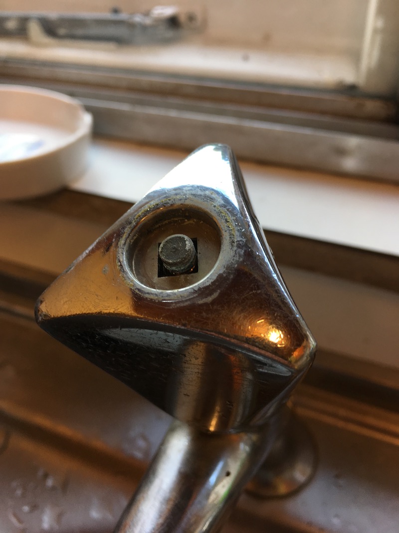

After isolating the water, and removing the top cap, I see this:
All I can see is the thread which the cap screws onto, and I'm not sure how to remove the tap handle. I've tried just turning the tap handle anti-clockwise, with a bit of force, but it won't unscrew.
Has anyone worked with this style of tap before? It might just need some more elbow grease to unscrew, but I thought I'd check first before I break the thing!
2 pry levers (screwdrivers) one each side and it will pop off, warning it might pop off and smack you in the eye whilst your knuckles smash the sink! :LOL:

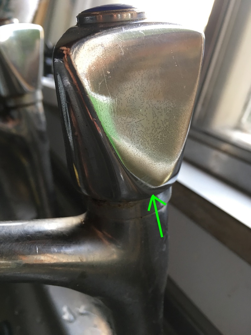

Here's a side view of the tap:
With the cap removed, should I just push up using pry levers where the green arrow is on each side?
Yep
Might have to go North & South and East & West a few times to get it moving though.
Trying with a standard screwdriver on all sides, but the thing is stuck solid. Will try and get some pry levers tomorrow and report back...
