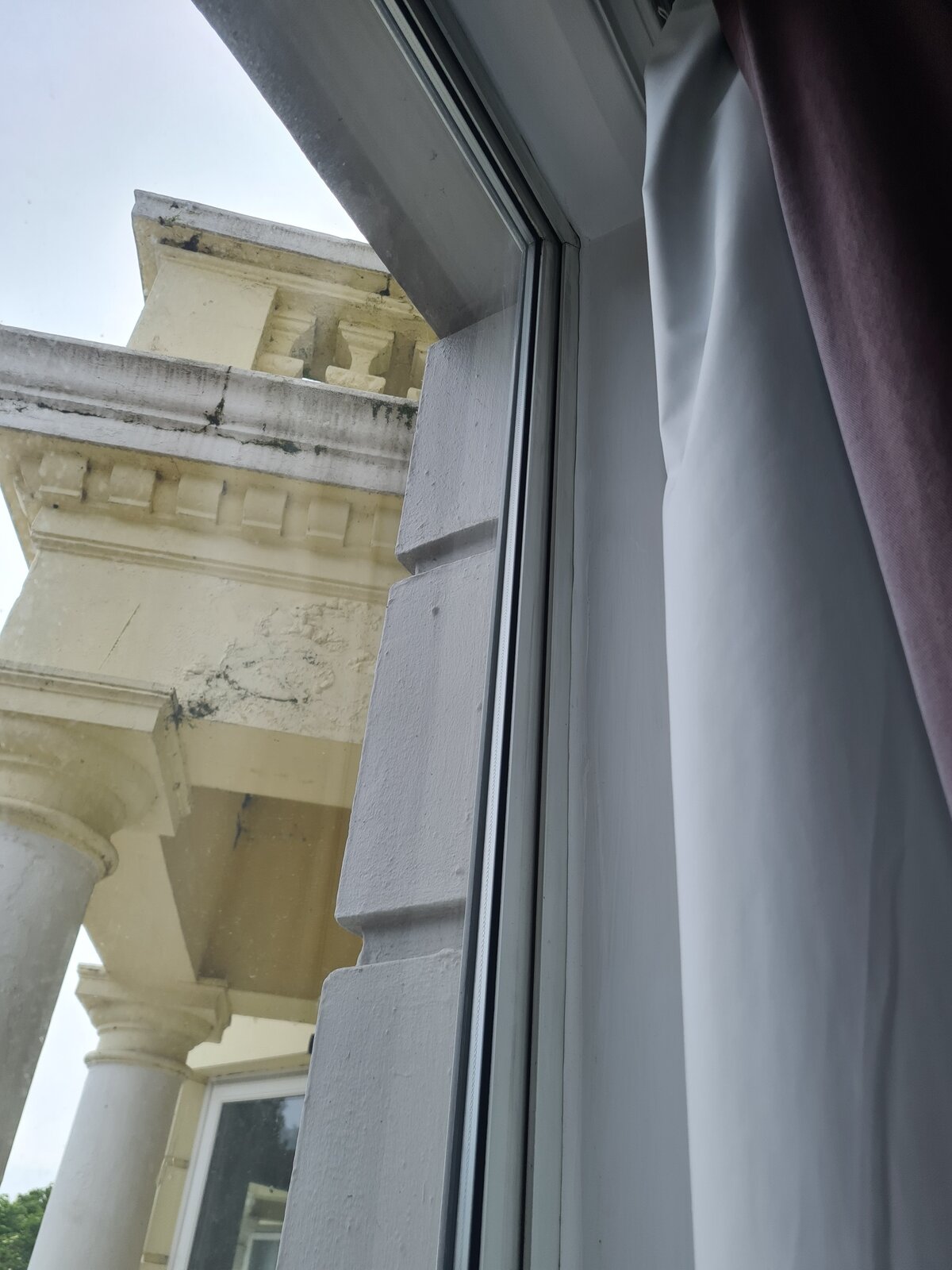

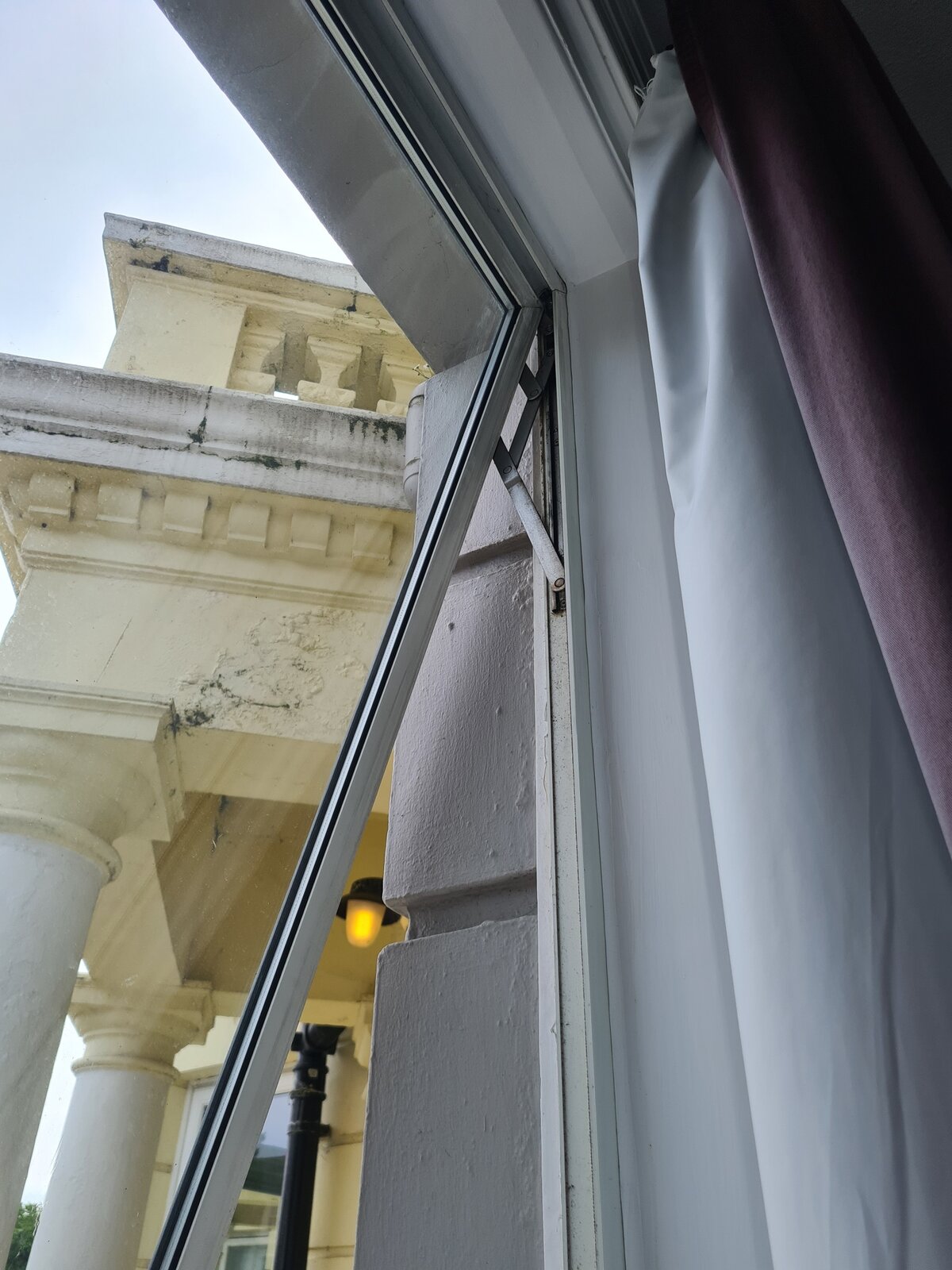

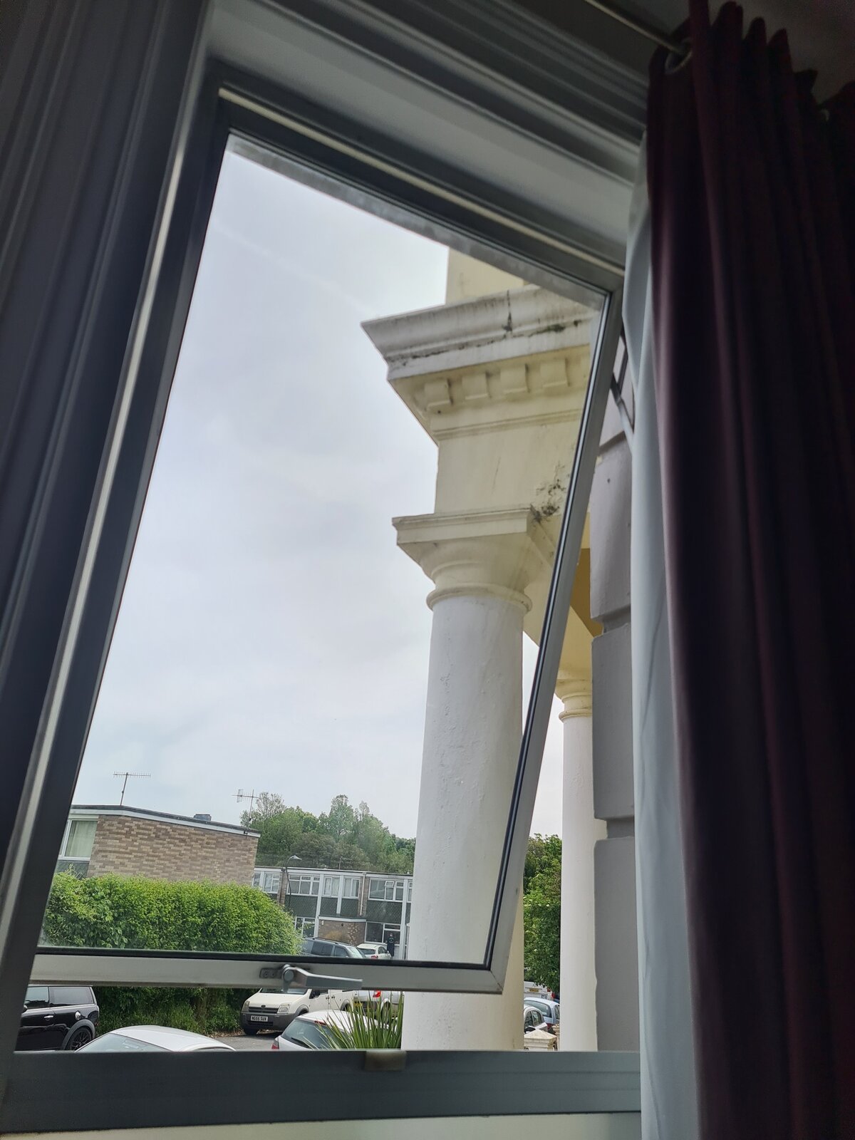

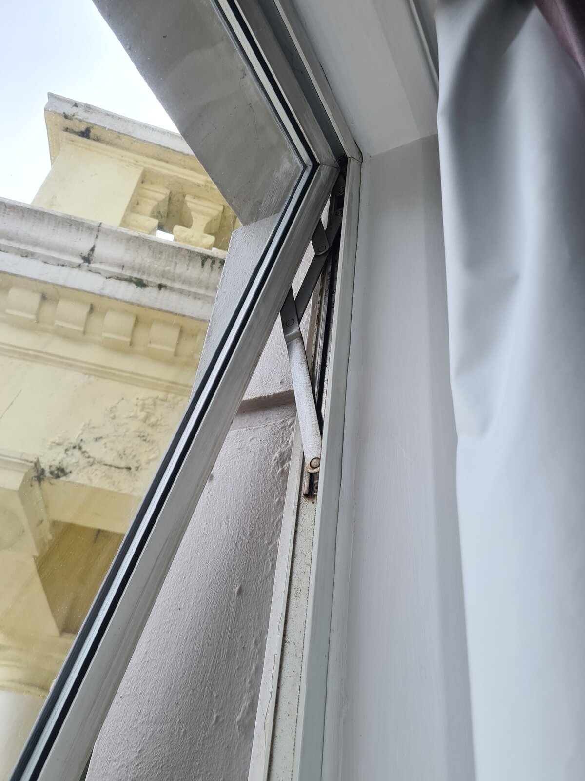

Hi,
unsure how good the picture would reflect, but when i close the window, the top bit does not close as hermetic as it should be.
Is that an easy fix? or should I get a window man over to repair it?
Many thanks

I expect the plastic slider in the hinge has broken common fault it stops the window closing as it should, easy replacement, heavy window to handle though.
This link has a picture showing the link that breaks.
