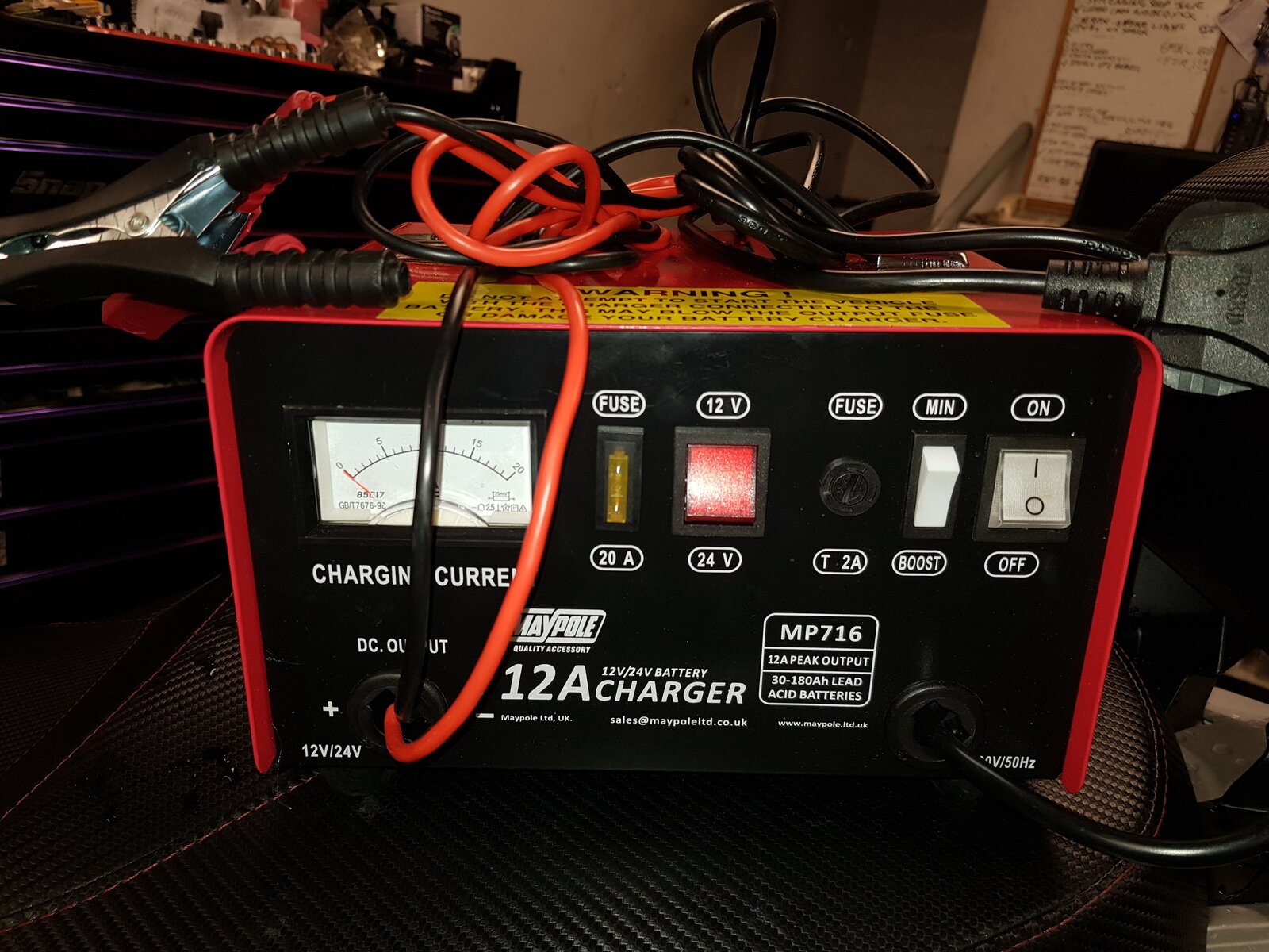

Hi folks, I'd be grateful for some advice on this subject.
I've not needed to charge either battery on our two cars for years, but with current restrictions limiting the vehicle's use I've had to dig out my 40 year old 10A charger with both 12 & 6v high/low options. I've done tests with a multimeter & come up with the following figures.
!2v High setting 15.2v
12v Low setting 12.2v
When I tried to get mA (current?) readings on my digital meter the screen remained at zero, but when the charger is switched OFF the reading becomes something like 27 & runs down to zero in less than a second.
All readings are taken from the croc. clips with clean contacts. Is there any life left in the old girl?

The voltage readings are about correct when connected to a battery but current readings need to be in series with the positive output wire. Most multimeters can’t handle more than a few amps - can yours?

Thanks for the prompt reply John. These readings are obtained when NOT connected to a battery, just on the bench.
I'm not that familiar with multimeters & mine is a pocket model Hilka with a 500v / 200mA limit. Assuming I'm right to use the mA range to read current, with the charger ON (again not connected to a battery) the screen remains at 00.0. Turn the charger OFF & the initial reading of around 27 is only momentaritly visible before the readings run down to 00.0 again in less than a second, barely time to read the pixels.
Should I repeat the test(s) when the charger is actually charging a battery ?
Always best to test these things with a load.....if you don’t have a battery handy, a 12v bulb will do - you’ll get more accurate readings this way.
200mA is much too small a current range, I’m afraid - ideally up to 10A is best. Bizarre readings from the meter are common on overload, before it blows the internal fuse!
For voltage readings, its across the two crocodile clips, for current measurements you connect one meter lead to the clip and the other to the load terminal.

Many thanks for your education in multi-meters, at least an overload means there is a current of some sort? I'll try to borrow a more suitable unit.

I blew the fuse on my meter trying to measure a current. Why not stick the charger on overnight and compare before and after voltages (after battery has had half an hour to rest from charging). I think it's only 0.5 of a volt or so between flat and charged.

I agree this is the best way, measure the battery volts before connecting the charger & again with the charger connected & on the high setting. You will know if the charger is failing under load or not if the volts drop down to the level of the battery only reading. A good battery should charge up to approx 13.5 volts, dropping to 12.6 an hour after disconnecting the charger.

You are a little low with the 13.5v. 13.5v will not charge a lead acid battery, it will just about maintain the existing charge. I would suggest the on-charge voltage should be nearer 14.1 to 14.5v. However an old design of uncontrolled charger like this, can go much higher and can cause excessive gassing and wrecking a battery, unless carefully supervised. Gassing has a risk of causing a very damaging explosion, spraying battery acid around [1]. Which is why modern chargers are voltage controlled or even better Smart Chargers. Personally, I would never use such an old charger these days, I threw all my old chargers out years ago.
After an hour off charge, a good fully charged battery should have a voltage of 12.5 to 12.9v.

Difficult to measure an accurate voltage, when the output from the charger is a very raw DC - likely it will be much higher voltage. Were I checking it, I would add a cap across the output to obtain a more sensible value of DC.

The OP's best way forward, if he must use that old charger, is to connect the charger to the battery and monitor the voltage very carefully, especially when it nears the gassing voltage. If the voltage gets to 14.5 I would suggest he then calls it fully charged and disconnects.
I don't really think the accuracy of the reading he is getting with the charger connected to a multimeter is that important, but it shows that it is operating to at least some extent so he then just needs to know if is breaking down under load (connected to the battery). I think it is fair to assume the battery is giving a reading of less than 11.5v if he feels it is flat, so if the reading he gets when charging is above that value then the charger is doing it's job, if it is below that value then it is not. If it is OK & he then wants to leave it to charge for any length of time I would suggest he switches to the lower setting 12.2v to trickle charge it. It will not charge above that voltage but will charge it enough to start his car.

I shall ditch the old charger (with full military honours) & treat myself to a new one. The largest of my batteries is 90AH & I'd want it to charge up overnight (say around 15 hrs.) so a 10A charger?
