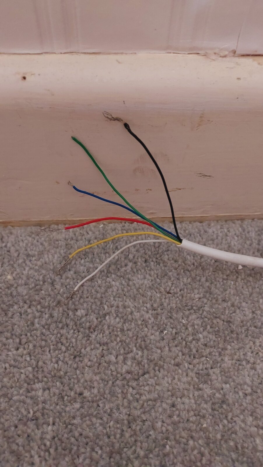

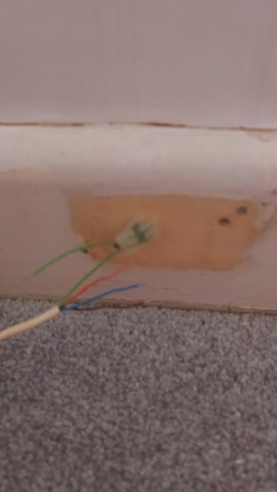

Moved into a flat and the intercom wiring has been cut.
Is there a way to reconcile the wiring from the handset to the wiring coming into the flat?

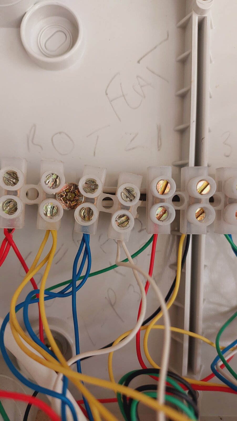

The Junction box

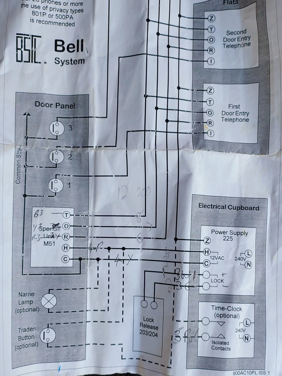

The wiring diagram left by junction box
Wiring into the flat

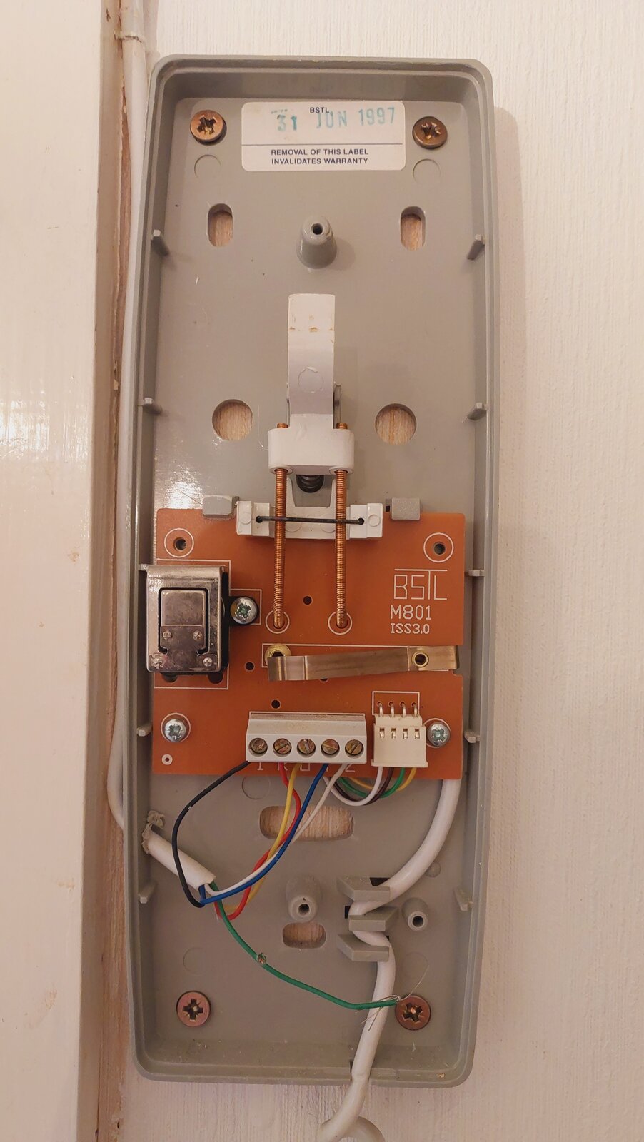

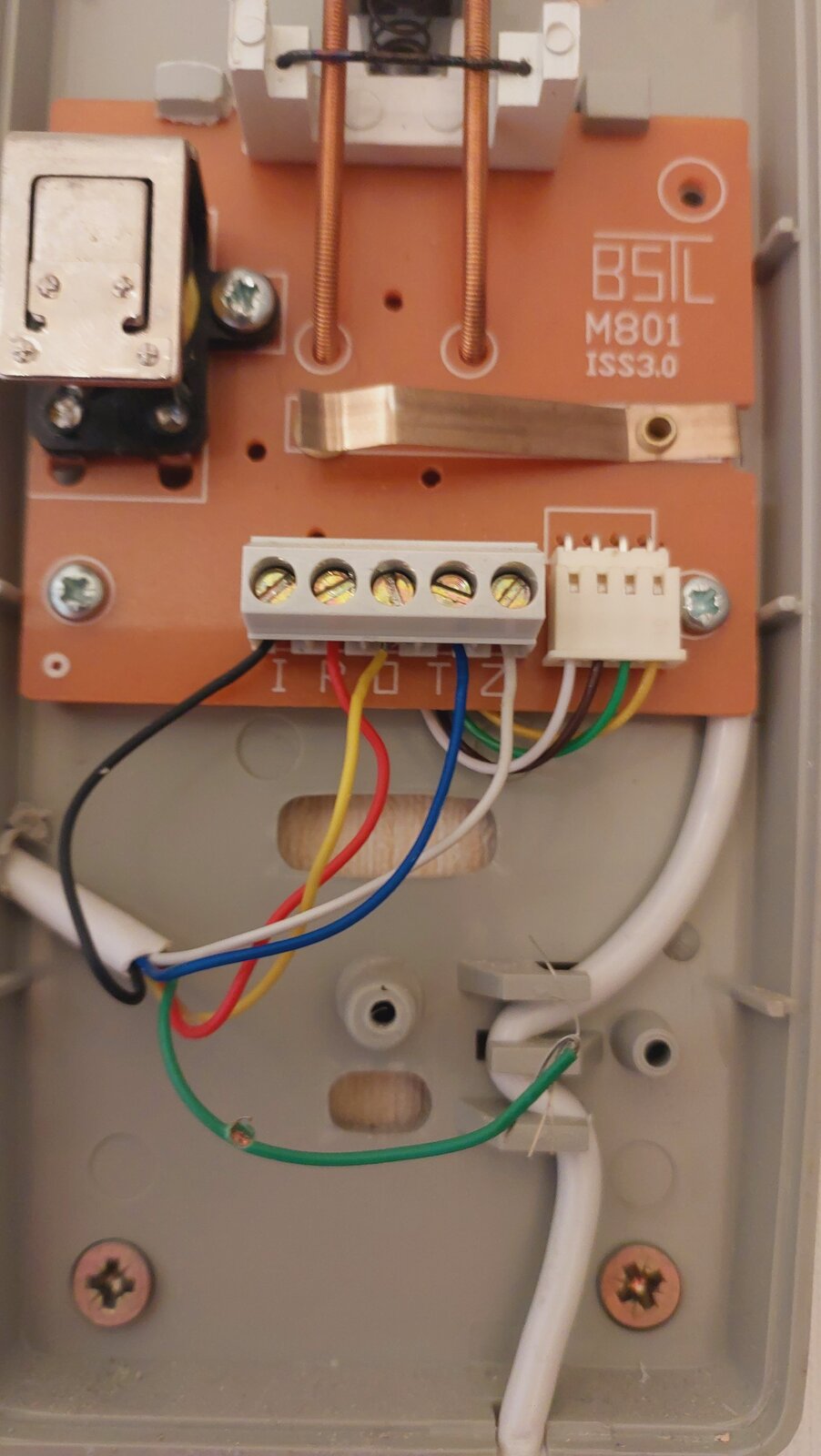

Wiring from handset

Is the wiring cut in the flat ? Is this a single or multi way intercom system ?
Looks like you have a 4 core coming in , this system requires 5 core fully function it could work without the lock release with 4 cores
It's for 4 flats. I'm in flat 1 and I've tried to show that in the junction box photo.
