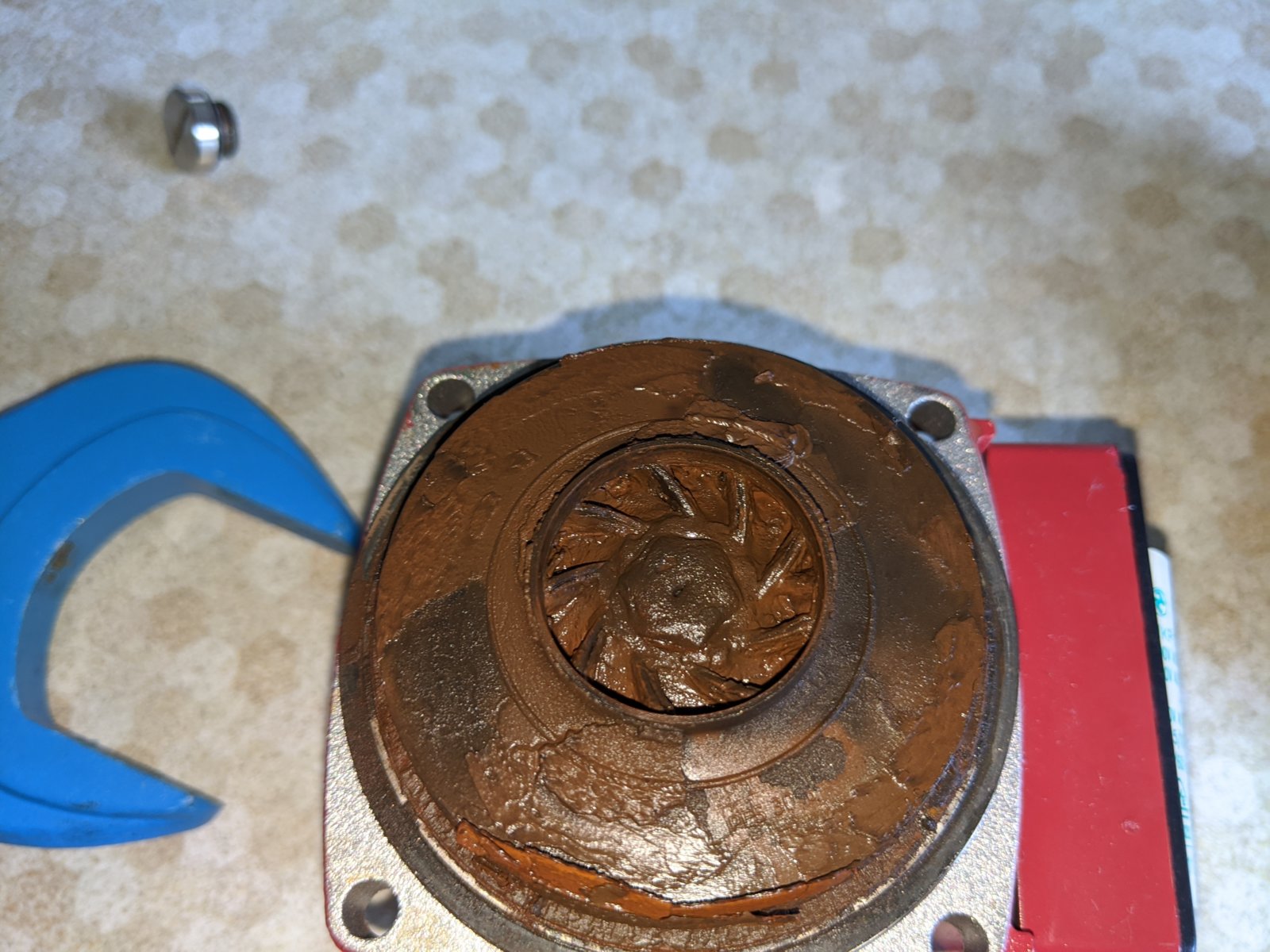

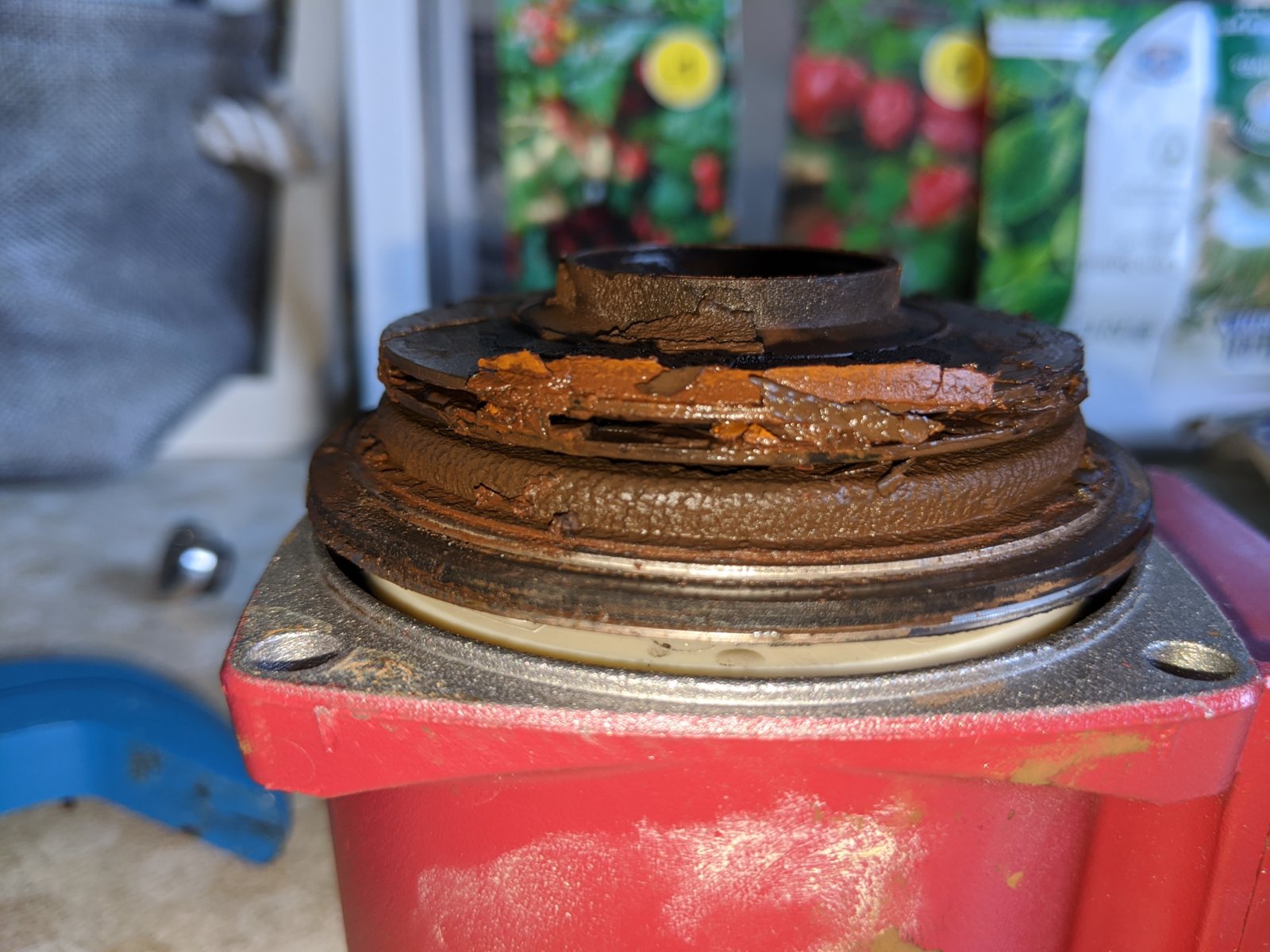

Just changed the pump on our central heating. What a difference! It was taking 2 to 3 hours for the radiator in the lounge to warm up and the boiler was making lots of clanging and banging noises.
10 minutes after I powered everything up, the radiator in the lounge was warm. 30 minutes later and it's hot. I reckon it was all being fed by gravity alone.
Anyway, I was looking for pictures on a new pump to see how bad our old one actually is. But I can't find any of the internal workings. Be interested to know what people think. Will the pump in this state have made much difference?
Also, will a new pump running efficiently make the whole system more efficient? i.e. will it potentially be cheaper to run?

That pumps in terrible state and indicates a whole load of problems with the system....it's rotten.
