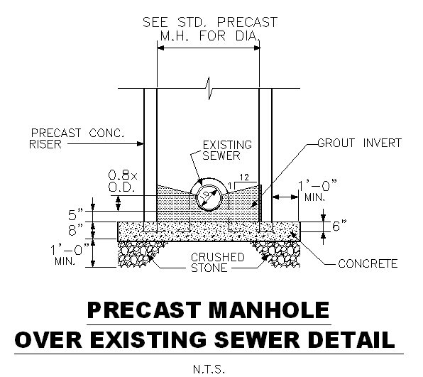

old clay pipes adaptor
19 Mar 2007
715
5
hi guys
this is my first post so im hoping someone can shed some light on this problem that im having
im installing an inspection chamber as im having my kitchen and bathroom extended, ive dug down where im gonna install the inspection chamber, however the clay pipes in the picture are of a very large size, i measured round the pipe and it was about 24" all the way round, so what size flexible adaptor do i need that will fit to a standard pipe that are used nowadays ? and where can i get this from ?...ive looked everywhere but no one does that big a size...help please
see image below of pipes.
www.imagehosting.com/show.php/367419_DSC00729.JPG.html
do you mean it is 24" external circumference? Is that 8" external diameter? What is the internal diameter?
Are you measuring the socket or the pipe?
I think that would make it 6" clay.
Would mean 150mm inspection chamber with adapters on the clay to suit. Hepworth Drainage do all sizes and adapters.
Why not just build a chamber and cut the existing clay to form a channel in the chamber with concrete haunching as here
