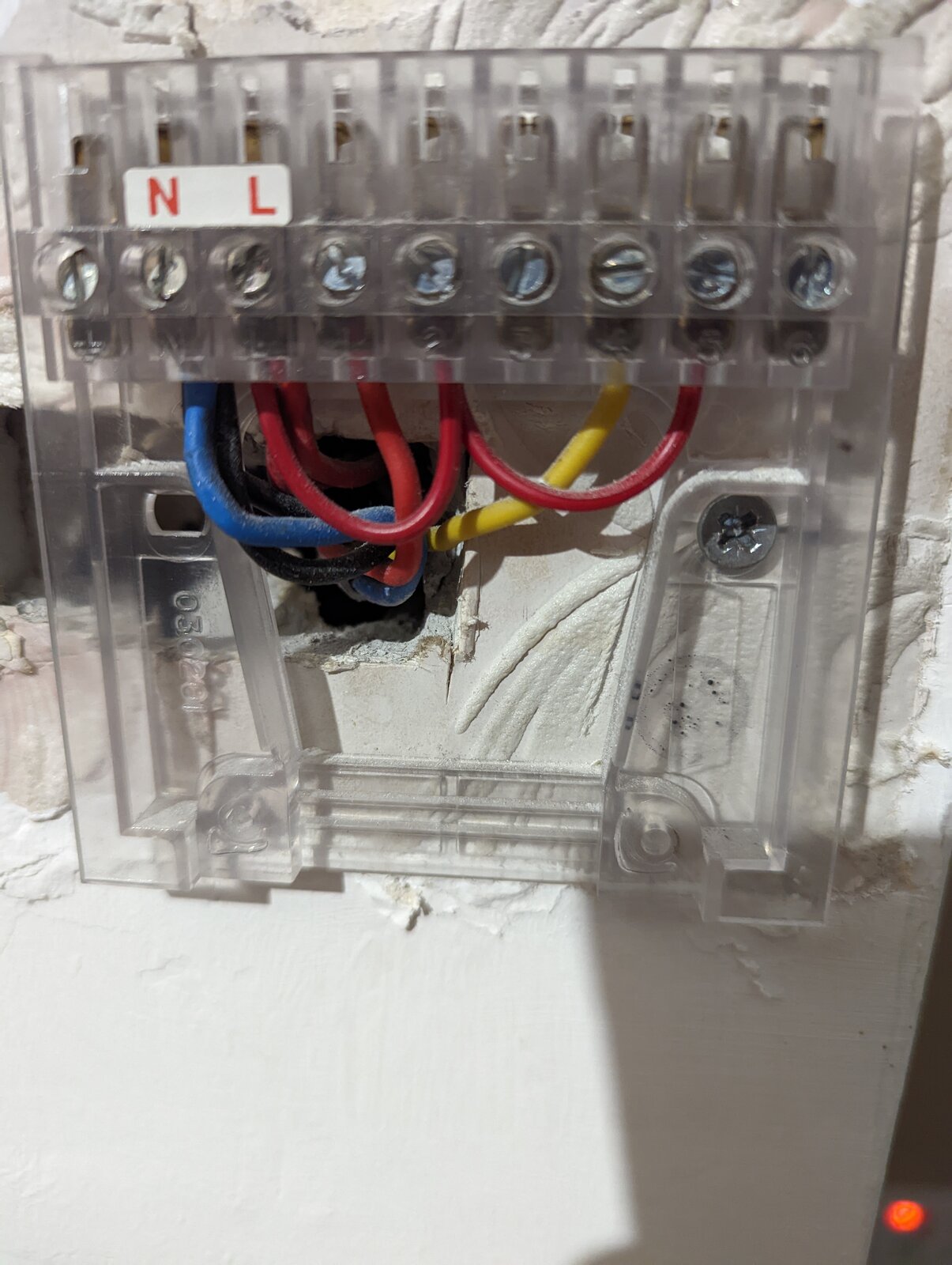

Hi guys, wouldn't mind some expertise!
I have a danfoss fp975 controller attached to my baxi back boiler in a Property I recently purchased.
I'm wondering which controller I can buy to replace the fp975, I can't make much sense online as to what would be compatible.
For reference I have attached the terrible current wiring to the fp975.
Again any help is appreciated. Ideally I was wanting a room stat in the hall, not sure if capable or possible.
I do see that some of the digital stats have L,N then 1-4 for 2 channel and thought this would work, please shoot me down if I am as i dont want to waste money!

The important Danfoss FP975 terminals are (1) with the red wire in to control the hot water, and (4) with the yellow wire in to control the central heating. The other wires are just there to provide power to the programmer and its functions. With a few exceptions,most new programmers don't need the extra links between (L) (2) and (5) as they have them built in.
You probably do need to confirm which type of system yours is controlling though, and it's difficult to tell from your description. With an old system having gravity circulation of hot water, the red wire controls the boiler, so whenever the hot water is set to be 'on' the boiler fires up and the hot water cylinder is heated by natural circulation, in that warm water rises, cooler water falls.
When central heating is required the yellow wire would become live and that start the pump. This then circulates the hot water around the radiators. (It can be linked to a room thermostat) However, the hot water has to remain 'on' as well, to keep the boiler running. So that's why the hot water comes on with the heating regardless.
The problem is that you make reference to a thermostat on the hot water tank......a basic gravity hot water system doesn't usually have this because then when the hot water got hot, the boiler would go off and so would the radiators. This is a restriction enforced by the antiquated plumbing......However, I suspect from the language that you use that this thermostat may be related to an electric heating element (immersion heater) and if so, has nothing to do with the FP975 or the boiler.
At the end of the day, if this is the type of system you have then any programmer that has the facility to control a system with hot water heated by gravity circulation will do. They ensure that when the central heating is switched on, the hot water also comes on automatically with it otherwise the boiler won't start. You can wire in a room thermostat to control the heating.
Many programmers have the function to control the old 'gravity' and newer 'fully pumped' systems. The FP975 you have has a switch at the back for the selection of 'pumped' or 'gravity'

You can add a room thermostat to control the central heating, but whenever the central heating is on the water will on too. Unfortunately, that can't be changed without altering the plumbing to convert it to a fully pumped system. which will have to be done at some point, as it is a building regulations requirement when the boiler is changed.
For now any 2 channel programmer will replace it provided that it has the gravity option. The Drayton LP722 for example. You can wire in a room thermostat to any of them.
If you wanted a 'smart thermostat' the Hive Dual Channel version has the required gravity option It includes a 'receiver' that replaces the existing programmer and has a separate wireless room thermostat you can put in your hallway.

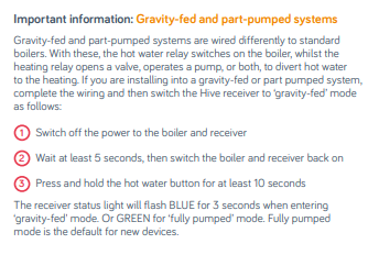

If only it was that simple. :) You still need to be careful. Hive refer to 'Gravity Circulation' as 'Gravity Fed'. However, from their description of what they mean below, it shows they do actually mean 'Gravity Circulation'. Confusing init. :rolleyes:

That's exactly it, i was struggling to work out what on earth it all meant hence why I ended up posting here!
