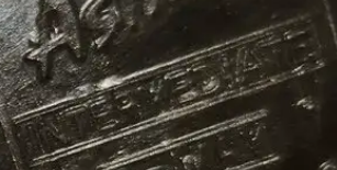

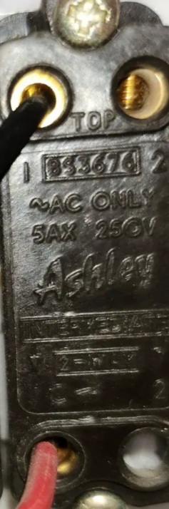

Saw a few of these posted but just wanted to check how I should be wiring this up. It's possible I have the wrong light switch (intermediate on google looks more like the old one)
Old double light (2 different lights) switch has this layout.

Red wires in the C terminals need to go in the two COM on the new. You may need a longer bit of wire for the link.
The red and black on the left 1 & 2 go to
L1 1. And L1 2
The black on the right 1 goes to L2 1

Your existing switch has exactly the same function as your new switch.
Imagine a 'V' shape with common at the bottom of the 'V' and L1 and L2 at the top of the 'V'.
The only difference between the switches, is for packaging reasons on the new switch, one of the 'V's has been turned upside down!
Your picture of the old switch is not an intermediate switch.
It's the same type of switch as your new one ,it's just the layout of the switches that's different.
Follow Taylortwocities advice above.
