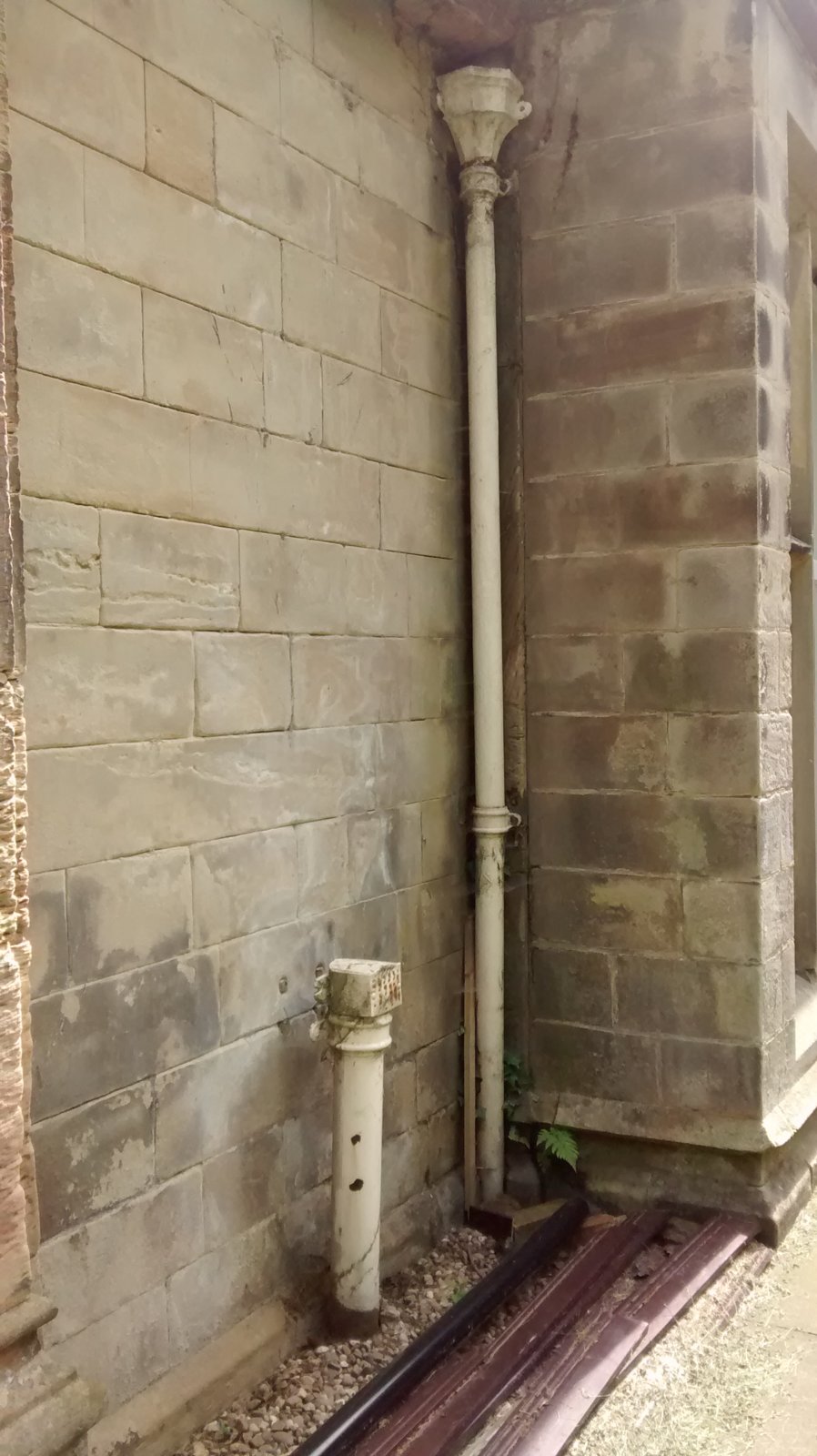

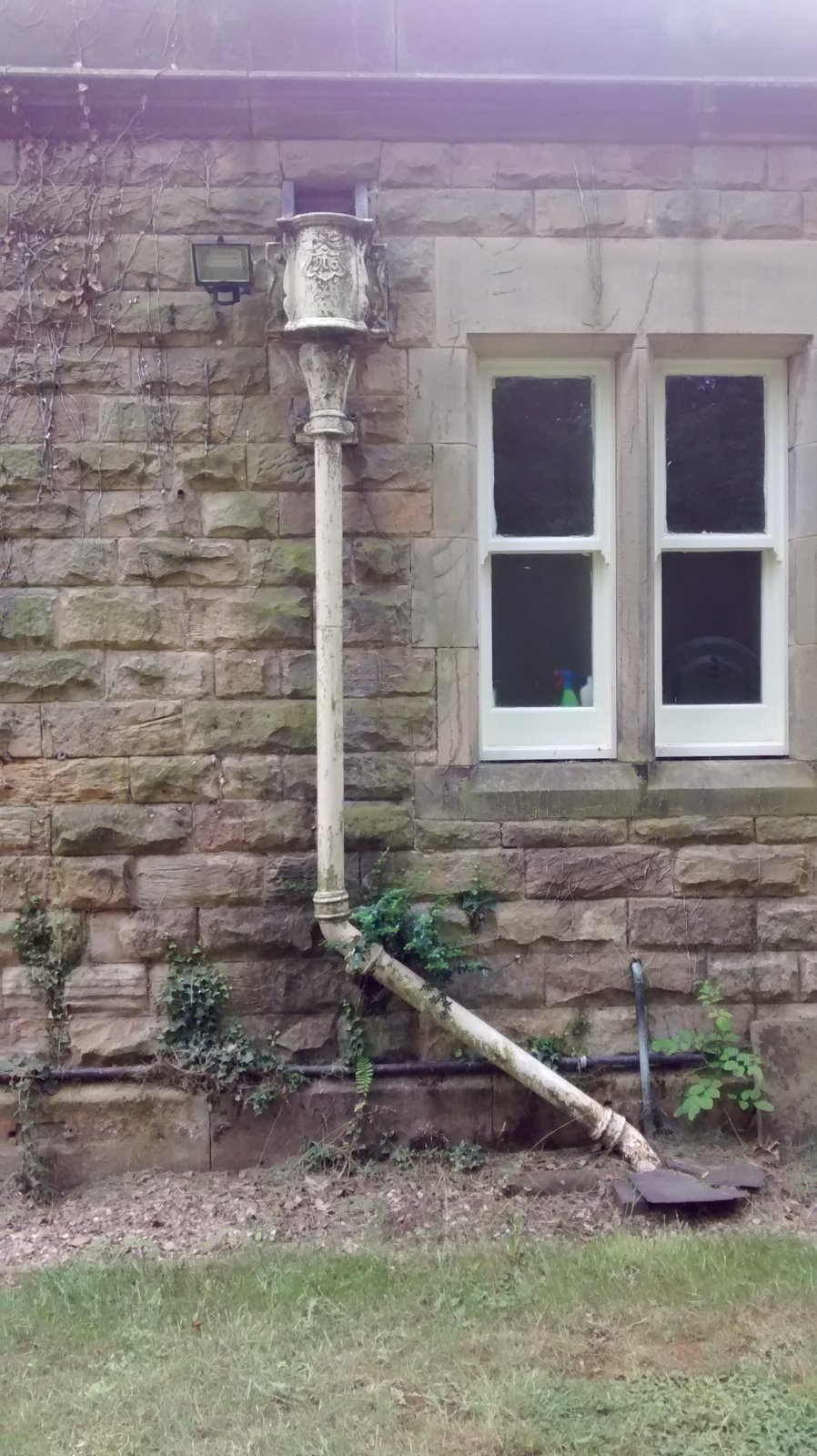

Hi all I have some old cast iron downpipes on an old stone building I need to clean up, they have years of neglect and are really tatty and rusted.
I was considering sandblasting but I don't think it would be a very cost effective method, although it would probably make a smarter job I think a wire brush or wire disc on a drill or angle grinder would probably be the most productive alternative method.
Anyone got any better methods.

I’d have a preliminary bash with a wire brush or a drill attachment wire brush first. See how it goes. If you’re properly p1ssed off after an hour with little results get them blasted. Lovely building by the way.
Could be a bugger getting them off.

Hi guys thanks for the suggestions, I'm going down to the site today so may have a preliminary test with wire brushing. Removal of downpipes and hoppers isn't an option unfortunately.
I'd considered sandblasting but after looking at the hiring costs to actual work to be done ratio it came out as too expensive. Also the stone work was also a big concern for me and also the ground, although the ground isn't particularly well maintained. Having said that I think I may have a small sand blasting kit and I've read that using Plaster sand actually works quite well as a cheap option, The only downside is the compressor I have may not be powerful enough and all I'll end up doing is creating a matt finish on flaking paint. I'll have to check the spec on my Compressor, it might give me the excuse to buy a new more powerful one :sneaky:
As a job, I really want to make this iron work pop and bring it back to its former glory so I'm not worried about putting the effort in, but I have to be practical as well.
Just had a root around in the garage and found a spot sandblasting kit from Workzone, Max working pressure is 3 Bar my compressor will go to 8 bar so I'm feeling a bit more optimistic. I also saved some large cardboard packaging from when I fitted my shower so I think that would protect the stone although I'll have a test first to see if the sandblaster damages the cardboard indirectly.

The vent wants removing and the pipe underground sealing up. Ugly pointless things - and yours has a cracked pipe. Put it on eBay for Ken to buy. Google Buchan trap ( or look at posts here on Diynot )
Well tried a bit of sandblasting, never again lol!
I thought the pipe was cracked but its actually the remnants of ivy.

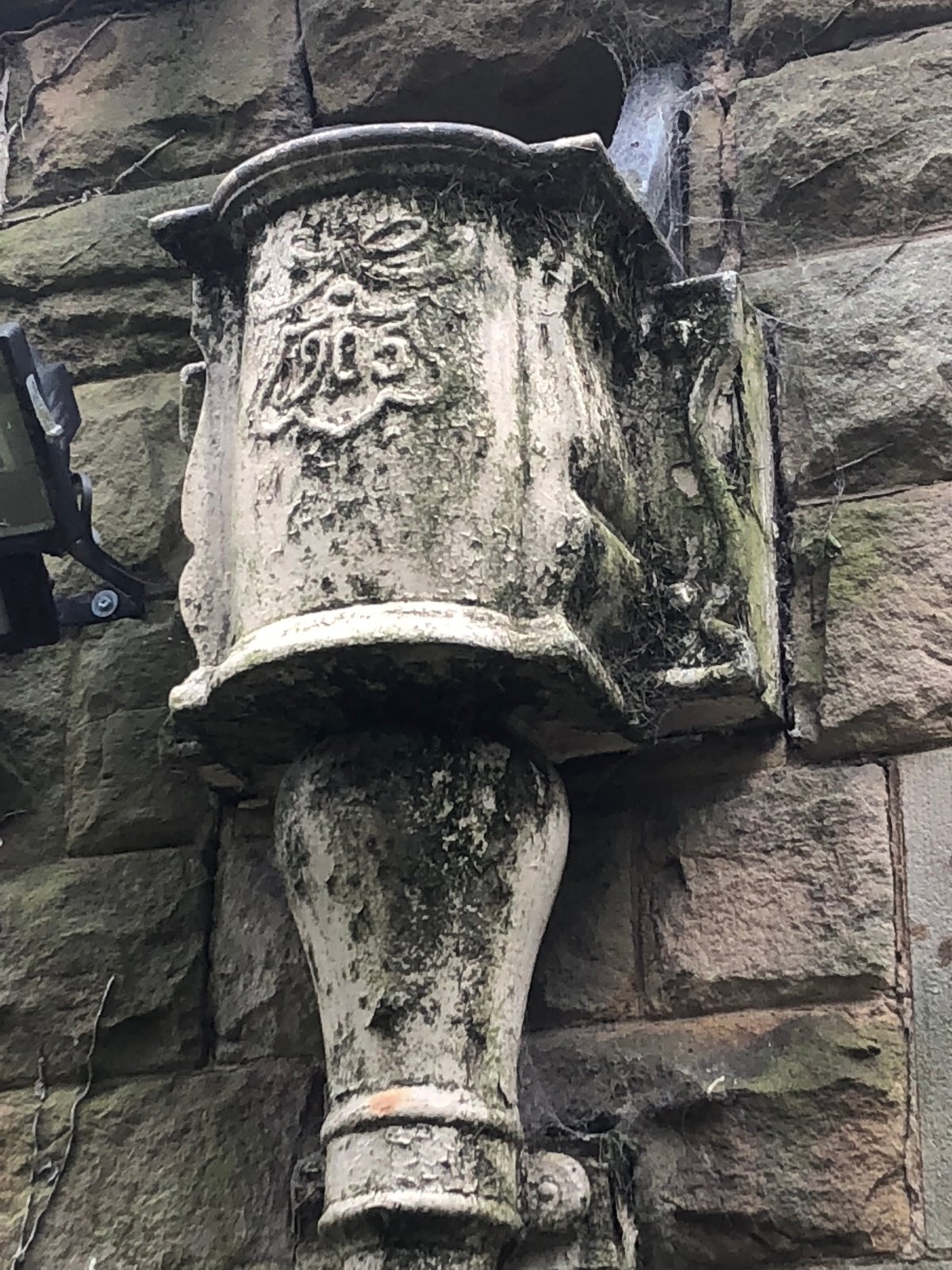

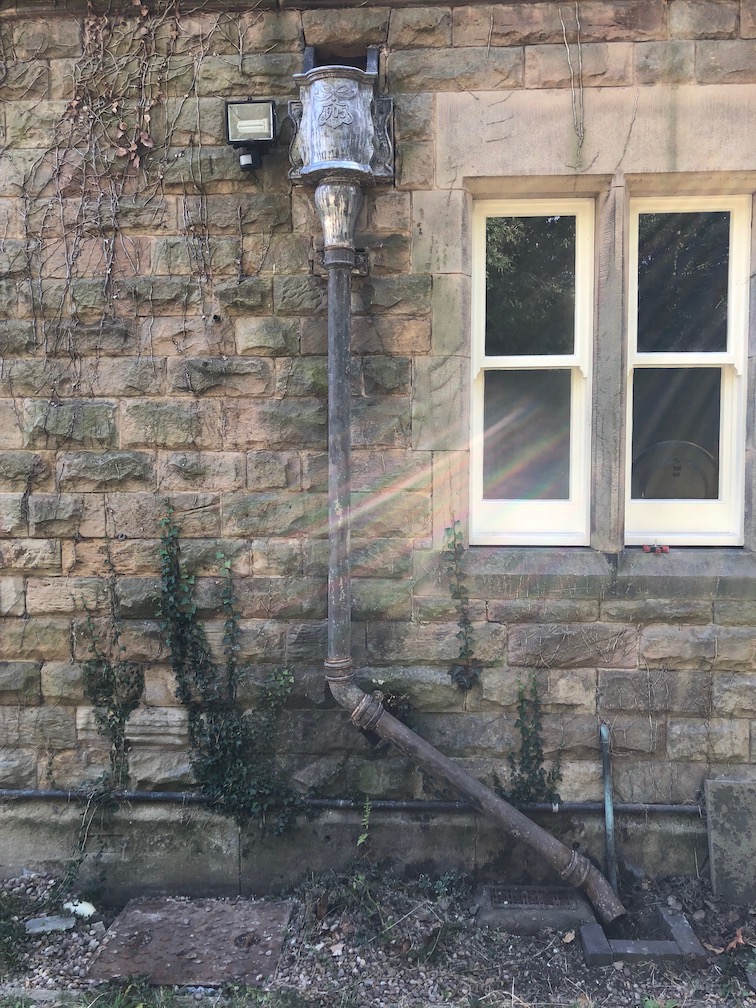

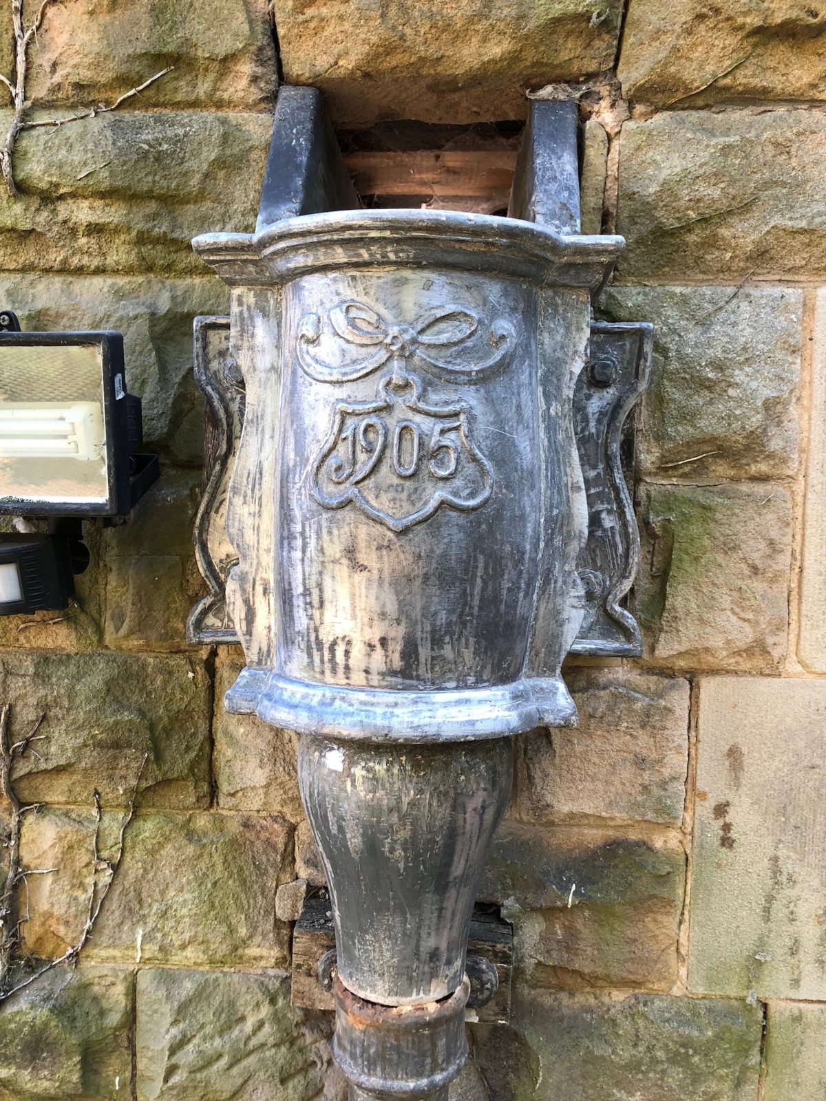

Long time passed since I last posted but had some unforeseen problems stopping me from continuing the job. Anyway went down today and started on the downpipes. Had a bit of a surprise because the hoppers were actually cast lead hoppers so I couldn't use the scaler on that, had to use blades and blunt screwdrivers and a lot of patience.
Got to clean the lead up tomorrow and buff it up to a more even finish, the hopper is not going to be painted now which I'm pleased about because it would be a shame to cover this up now, but the downpipes will be. I actually like the downpipes as it is but unfortunately they want it painting so it gets painted.
Got to putty the joints too.
That hopper is beginning to look good,
Word of warning, wear a mask when working on such material.
As from now on and what to do with it?
Sandpaper or rough emery cloth but, [there is generally a BUT?] try to rub in one direction the marks left will be visible for a long time.
Or protect the wall and use an Acid wash or a paint stripper? on the hopper??? paint stripper will bounce of the lead but make life easier for you?
As an aside, there appears to be a gap between the lead hopper and the down pipe?

@kenmac: I always use protective wear, especially on jobs like this, it's a fool who doesn't. A mild acid wash might be the better option, I was loathed to use the tools I did but it was the only way to get the paint and crud off.
Yes I'm aware the old pump has the plunger missing, that's a shame but it's just an ornament not a working object, I may add a pseudo plunger for effect at some point.
The hopper will not be painted it will remain bare but cleaned to a more even finish.
The gap between the lead and the cast iron downpipes will be filled with a putty.
@Bobased: The option for removal would have been nice but the owners didn't want it removed so unfortunately it had to be done in situ, believe me, I would have rather removed it and had someone else do the hard work. The back of the downpipe was stripped using an angle grinder and straps of emery, the cast iron is in surprisingly good condition, no holes or excessive rust. The downpipe will have an etch primer applied prior to 2 undercoats and 2 coats of gloss.
All of the downpipes on this property are painted in BS 10B15 so it will be repainted in that colour. The windows I painted previously are the same: BS 10B15
darkan9el, good evening again.
A consideration?
Is the lead hopper vulnerable to the attentions of metal thieves? can it be seen from the public footpath?
If so you have a dilemma, if left "looking like" lead it may vanish one evening? if vulnerable you may have to consider disguising the fact that the hopper is indeed lead, a coat of paint to blend it into the cast iron??
If a camouflage ploy cannot be achieved, i would take images of dimensions, meaning hold a tape at all salient areas and take digital images of the tape so that if the thieves strike, you could? somewhere get a specialist to re-cast a replacement??
Ken
Hi Ken, that's a very valid point, they do have other hoppers that are not easy to access so they have copies to hand so to speak. The location is away from any public roads and is very isolated so it cannot be seen and security is very high. I think I will mention this point to them and at least the can make a considered choice.
