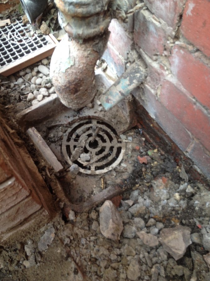

Do you know if i can get a replacement for this clay drain top. It is broken in many places and has now been removed. I went to key line today and they have a replacement, but they are £70 plus vat.
Do you know if i can fit a plastic replacement. The opening into the drain pot / chamber is 6"
You might get a "Salt Glazed Gulley Top" as a like for like swap. Or a modern clay gulley to drop into the raising piece.
I dont know what they cost. Stay with clay, no plastic.
But you should dig out and expose for a pic whats going on with both the gullies in your pic - then you can see how they drain away and if there are any cracks below the soil. Perhaps you really only need one gulley for one down pipe?
The cast iron down pipe looks very old and delapidated.
Whatever you do give the gulley traps a clean out.
Yes they are clean now and cast iron has gone to be replaced with plastic.
Both traps are separate.
I have looked for a glazed top and may be able to get one. Fingers crossed.
