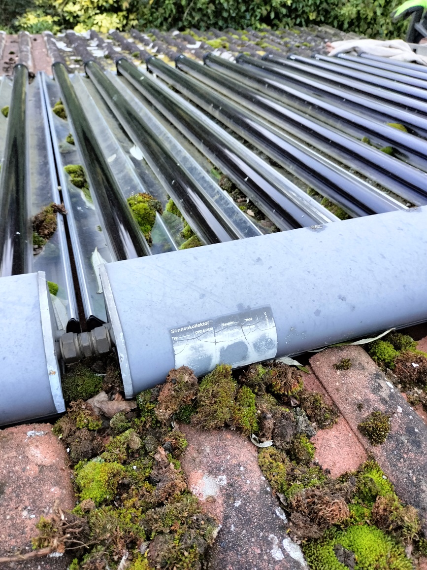

In the cylinder cupboard is a nightmare of piping. There's so much of it. The cylinder is dated 2005 and is plumbed into a Simplee Solar system that has 3 tubular water panels on the roof. The cylinder also has Simplee Solar on it. One of the panels on the roof is pouring out water. I've turned OFF the water supply to the panels, which was fully ON supplying full mains water pressure to them. I'm sure this is not correct and they should only be filled to a certain pressure, and this is why one has blown. There is a pump on this system that I believe is purely to circulate through the coil in the cylinder, under control of the Simplee Solar controller. Weather permitting we'll get the panels down in the next few days and see what we can do.

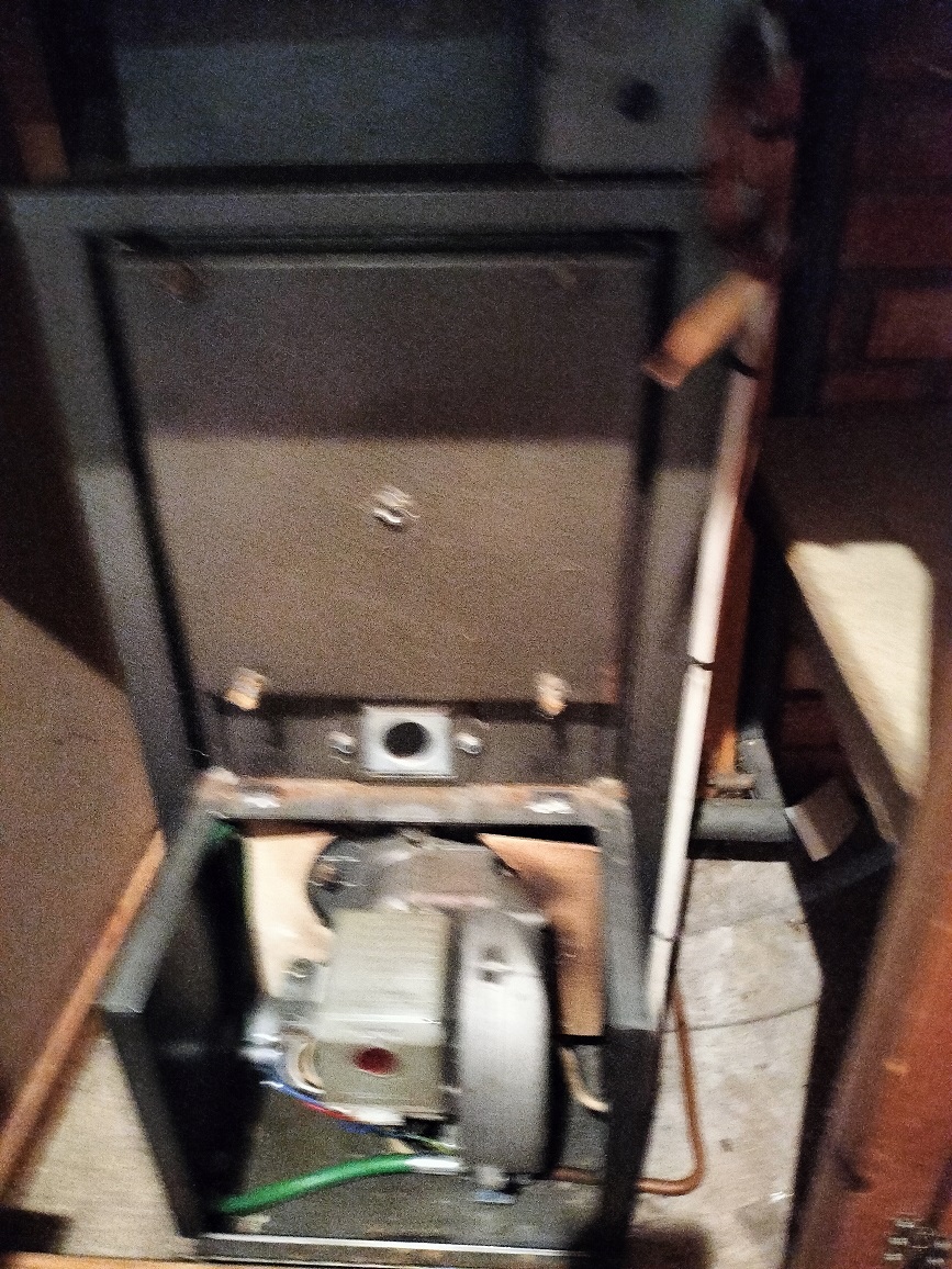

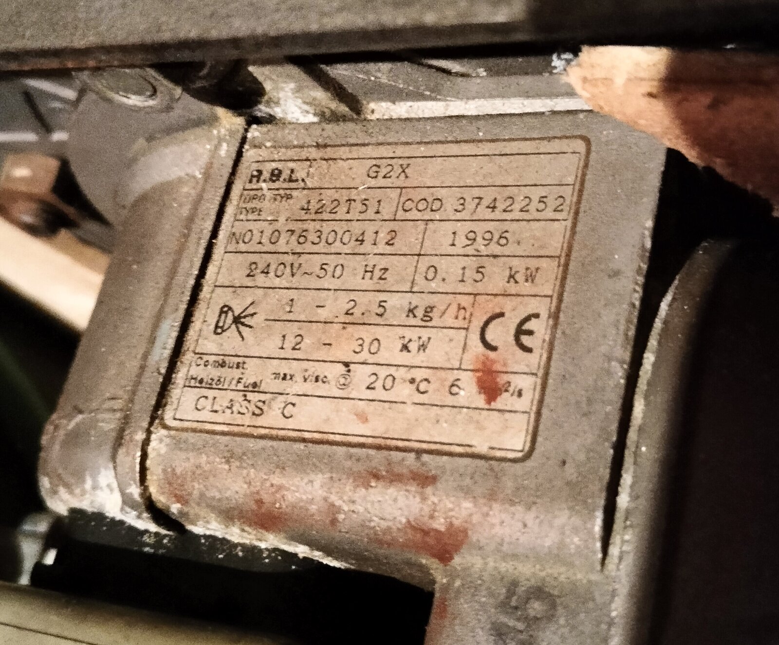

Also in the equasion is a very old oil boiler (1995) that as far as I can tell is a Firebird 60/90. Sorry, this pic is terrible.
The 1200l oil tank has only a few inch of oil in the bottom, and is no higher than the boiler. When I disconnect the green flexible pipe from the boiler no oil comes out. I can suck it and draw oil from it very easily, but there's no gravitational feed. I've ordered an oil delivery but that won't be here for another week. Wrong time of year I think.
I was able to get the boiler to fire and run for about 1 minute, but after that it only goes to lockout. The fan runs, and I can hear something that I think should be ingnition after about 10 seconds, but back to lockout every time. There is no pressure guage in the oil line.

1. Is it a Firebird 60/90? If not, what is it?
2. Can anybody supply me a user / tech manual?
3. Should this boiler draw oil? Or does it rely on gravity feed?
4. How audible should the ignition be?

The attached should help, the boiler manual is for my 2015 Firebird.
Do not attempt to refire the boiler until you get a "fill" of oil.
When you do, ensure boiler switched off and remove the blank plug (3) marked gauge connection, let oil flow out into a can for a minute or two, reinstall and tighten the blank plug, boiler should then fire up.
DO NOT under any circumstances touch the pressures regulator plug (4).

I would add to above as its been stood for 4 years make sure flue is clear & take out boiler baffles and clean & make sure all seals are sound.
You can't make any meaningful changes to a oil burner without a minimum of oil pressure gauge and combustion analysis equipment.

On a good note we did manage to repair the leaking solar panel today. Soldered a piece of copper pipe over a 1/2" split in the manifold pipe. Suspect it was from freezing. I think I need to add antifreeze when it's re-instated tomorrow.

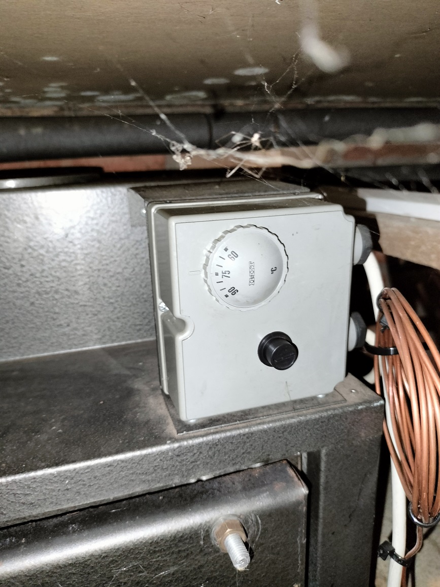

Another question.... there is no cylinder stat or room stat. The prog has DHW only or Heating And DHW. There is a valve that blocks the heating circuit and directs the boiler to the cylinder only, or opens and shares. Sure there's no probs adding a room stat to the heat output from the prog, but is the principle that the stat on the boiler is used to regulate the cylinder temp?
Early heating systems often used to run on the boiler stat only with no room or HW tank stat. Sometimes they would have what was called a cytrol valve on the supply to the hot tank to regulate the HW temp but they didnt work that well.
Put the solar panel back into service today, but just as light was fading and it was starting to rain. Filled it with antifreeze. No idea if that's right or wrong. Used a stand pipe into the top of the system on the roof and let gravity do it's thing. If there's any sun tomorrow we'll find out if it works!
There's no extra valves anywhere that I can see so it's as basic as it gets. If all is goot I won't worry about a room stat, but that's for my son to decide in the future. For now just need something working.

Nothing wrong with basic. Less to go wrong and if properly designed and installed will likely work just as well as any modern system thats rammed full of gizmos.

The solar thermal system seems to be working... if the sun ever puts in an appearance.
Yesterday we had only a few minutes of sunshine. Today almost an hour!
But during that hour the collector got to an almost impressive 33' and I could feel the water going into the cylinder was pleasantly lukewarm!
