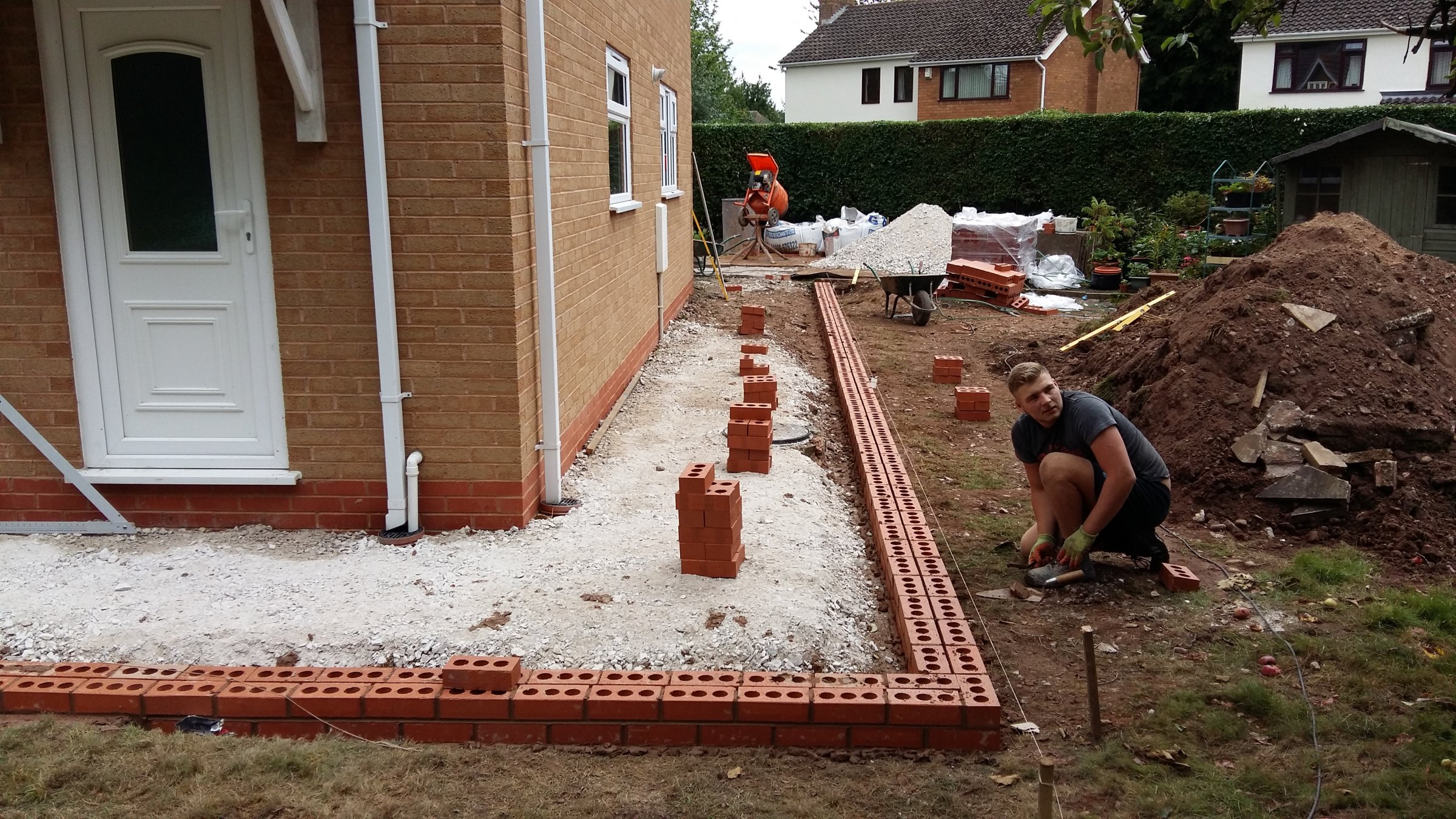

Pics of the madness are here

Nice pics Rich. The only mistake I can see is that you allowed the slabs to oversail the wall when building an awkward curve (yours is a quadrant). It's always better to bring the wall up to the same level as the slabs and finish the wall with say a solid blue brick laid flat. This means that the wall can frame the slabs and avoid problems with little slab cuts tipping.
We often bring the wall up to the slab level....
Ah yes, that edging does look nicer! I sort of did mine without thinking, then planned to render it, then attached the bamboo. I think I had had enough by the end! I enjoyed it for a few years, then moved house.
I have since paid someone to lay a patio and it's absolute Crayola compared to the one I did. :(

Apart from the look of it, is it better to have brick edging? I am planning to have sandstone slabs laid on a concrete base (rectangular, so no awkward cut bits).

In instances where the patio is on a higher level than the surroundings i.e. when a retaining wall is required, then it is often better for the wall to finish at the same level as the slabs rather than the slab form a step over the wall. This is especially relevant when building a curved wall because you will always end up with small cuts when doing a curve - hence the need to 'frame' them in.
You can also end up with settlement differential meaning the slabs can end up cracked or dislodged from the bedding.
it will be built on the flat, with the bricks level with the slabs.
I meant to have the brick edging as a "frame"
I'd like it to look like this
