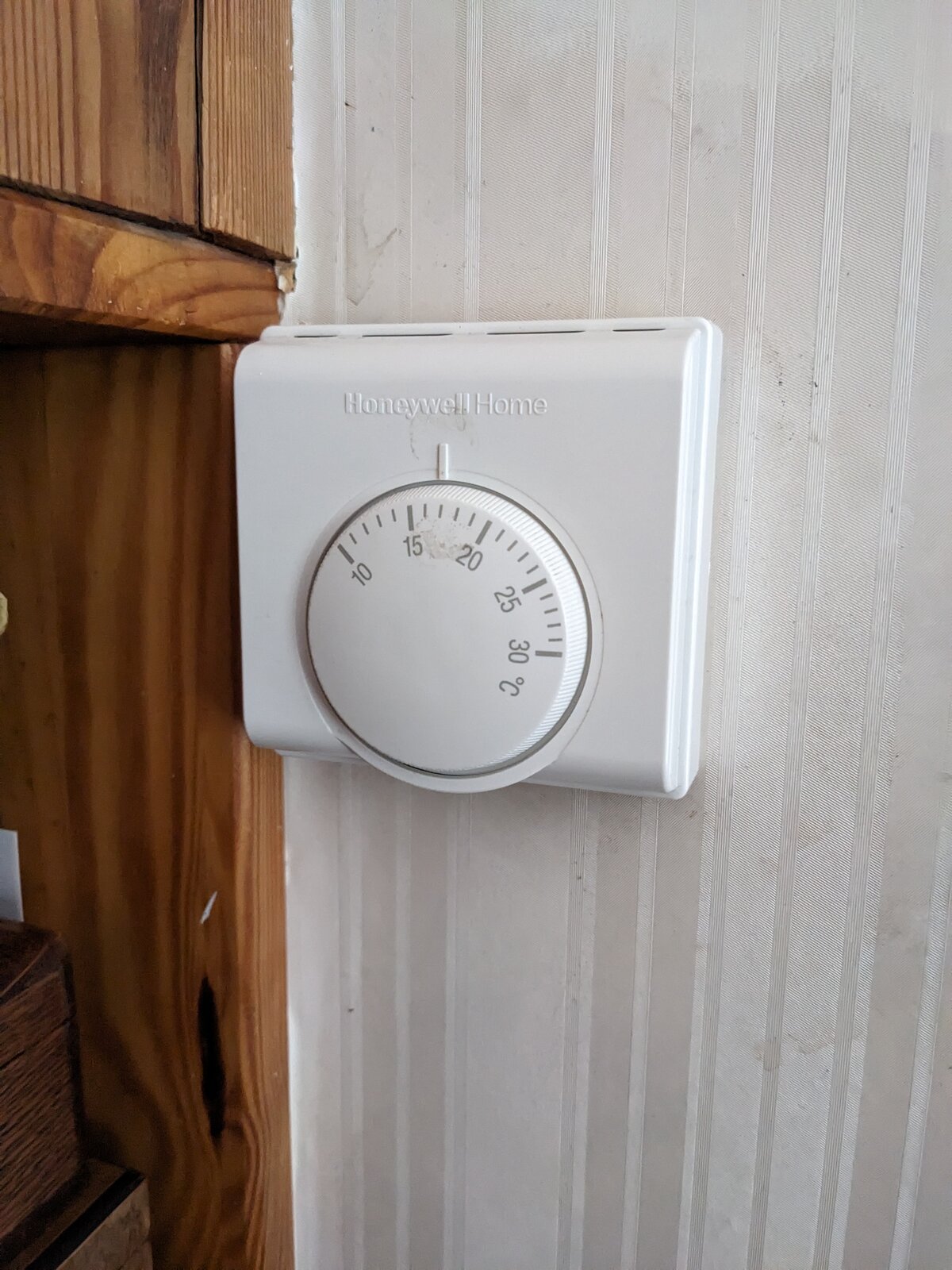

Probably an obvious answer to replace it, but has anyone else had this? I only noticed it today as I was aligning the dial so it clicked off at the correct room temperature (it previously read 10, but came on when the room temp was 15) and noticed when refitting the dial that if I press it straight in, the thermostat clicks off (only while held in)
Certainly a non issue, but is it a sign the thermostat is on its last legs and might need replacing?
Seen it many times. These old design thermostats have mechanical contacts that have a bimetallic element that moves as the room temperature changes making and breaking the internal switch and turning the heating on and off accordingly. Pressing the dial flexes the unit and operates the switch. It doesn't necessarily mean that it needs replacing, probably it would have done it from being new anyway.
