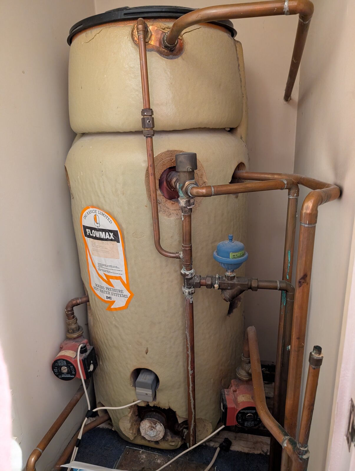

Thanks all, yeah I suspect it's cylinder insulation causing the issue. I say issue, it's fires up quite often and for quite a while. Def on more on than off.
The cylinder is also very old and apart from some rusty sections in the jacket it's also doing ok and no leake. Pic below. What insulation would be best to add, I'll get some tomorrow
Might not be the insulation. Check that cylinder thermostat is attached properly would be a good start.
Does it look incorrectly fitted? I presume its the white and grey box at the bottom.
Is the cylinder jacket enough or could it be better insulated
Yes it's the white and grey box. Hard to tell, I've not seen one like it before.
It's pre-lagged, so no additional insulation required
Ok well in that case I'm not sure where to go with this. I wouldn't know how to check the stat, so will prob have to get an engineer in and make sure the setup is working optimally
They should usually be strapped to the side of the cylinder making contact with the bare copper.
ah okay. No idea! If i fiddle with it, or even disconnect it, I can imagine knowing my luck, we'll lose the system and I'll be upgrading a lot sooner than we budgeted for

You could try checking the stat is tightly clipped to the bare copper, they normally have like a net curtain spring, around the cylinder, pulling them tight to the copper.
You might also check the operation of the stat - mark the temperature setting of the stat, on the dial, then adjust it up and down, there should be maybe 5 to 10C difference, between the clicks it makes, and the clicks should be sharp and clean.
Usefully, you certainly could add some insulation around it. Mine is yellow insulated, and adding an old bed duvet made an appreciable difference to how long mine retained heat. You only need to add extra insulation around the lower 3/4 section, the top 1/4 is a cold header tank.

Thanks for this, very detailed info. The stat seems to be screwed on and against the copper, it seems solid but not sure what else I can check without unscrewing it off. As for the temp, how do I find this? Is there a way to open the plastic housing and does it contain a gauge? The only setting for our hot water (that I was aware of) is on the boiler (0-6 and it's on 4)
