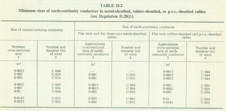

From the 14th edition, 1966:

Thanks for the comments. I'm pretty sure it's imperial, I measured the strands at 0.72mm diameter - I wouldn't swear to the 1/100 of a millimetre, but to make it 2.5 sq.mm would need a diameter of 0.67. All wired up, tested, connected and working now.
Following up comments I checked out the CPC. Although there are only three strands, they are larger at just under 1mm diameter. This is consistent with the table posted above which specifies three strands of 0.036". Either way if my maths is correct this comes to around 1.9sq.mm. So actually larger than today's cable? I believe even modern 4sq.mm cable has a CPC of 1.5sq.mm, so presumably that's considered enough for a 32A circuit (assuming impedance within limits).
