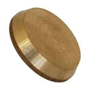

You could try a blanking disk, but you'll only find them in 15mm.

whats the difference between a blank nut and a blanking disc and why would you use one instead of the other?

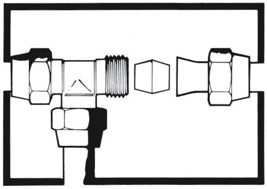

Prestex is a brand of compression fittings made by Pegler.
They used to do both Type A and type B joints, but now only do Type A.
Type A:
View media item 46717
Type B, where the pipe is swaged or belled out:
Blanking disc, as shown above, goes into a fitting, replacing the olive.
Blank capnut replaces the olive and nut, and should come with a rubber washer.
