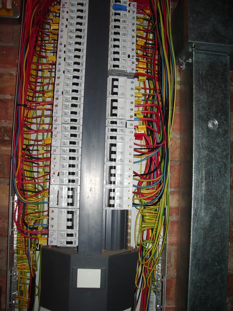

We have an old 36 way board 3 phase , 4 mcb's need replacing, only temporary till the board is replaced.
They are 6 amp which I have not seen before (usually 5 Amp)
Read somewhere else that hagar MT range fit.
Anyone tried them and know if the MT range is still current as I do not think it still is.
I know this style hager does fit old style sentry boards very well, and although it is not good practice, I'd be happy to do so as the old sentry MCBs are not available.
You may need to remove a piece of plastic from eitehr side of the bottom teminal screw (It is designed to be removed)

If you get really stuck, I think I have 4no. SP hager breakers in that style in my garage.
Thanks RF
Think the MT is old, and now MTN as I needed one last week, the MT and MTN both fit the hager boards ok but not seen an NC , so
will see if thats available.

AFAIK, there have only been three styles of hager MCBs.
The old BS3871 type, the type I pictured, and the new type with the wider grey lever.
What type is the one in your pic? It looks the same as the one my pic (from TLCs website)

The one in the pic is a MT 110, next to a 5 amp, old mk sentry, hagar says they have not made the MT for some time.
I recently brought a MTN which has a little plastic clear cover on it, which appears to be the current one.
I will phone hagar about the NC that you are showing.

Blimey rf, what with that and your data box, you must work in some big old places
I lost count is that 72 way
Till now I thought this was a lot
Lets just say I don't do domestic :LOL:
That DB is in a well known local convenience store (where Crafty works)
Not one of my installs, just working on it.
