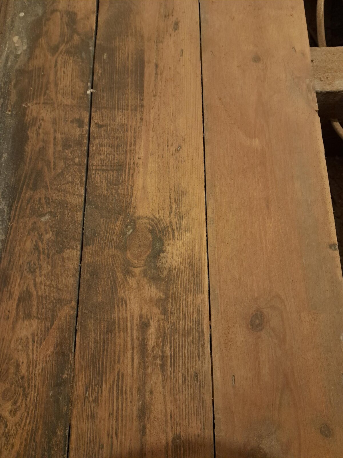

Sanding up old pine floorboards, maybe up to 100 years old. Rough sand of most of them went ok, but round the edges there is a thick, sticky black paint that I'm really struggling to shift (see pics below). It seems to go pretty deep into the wood. If I can shift the paint, thinking of dyeing the wood either white or a light oak.
Think the options are:
1) Just keep sanding til the black paint is gone.
2) Try a chemical stripper - any recommendations? and do you sand a bit first then strip, or strip then sand?
3) Get up all the painted boards and replace with ones from downstairs which are going to be covered?
4) Give up and put something over the boards.
What do you think? Thanks.

I've been using an old 850W 4" belt sander with 40 grit belts. I've got a plane I could try although the paint is all round the edge of room so getting the bigger tools in is tricky. Unless I could go at 90 degrees to grain for initial pass?
I'll try the belt cleaner too cos this paint is gumming up belts in no time, almost like it's bitumen or something. Probably just old sticky floor paint though.

It'd be very unusual to find bitumastic paint indoors so i suspect some kind of glue has been used.

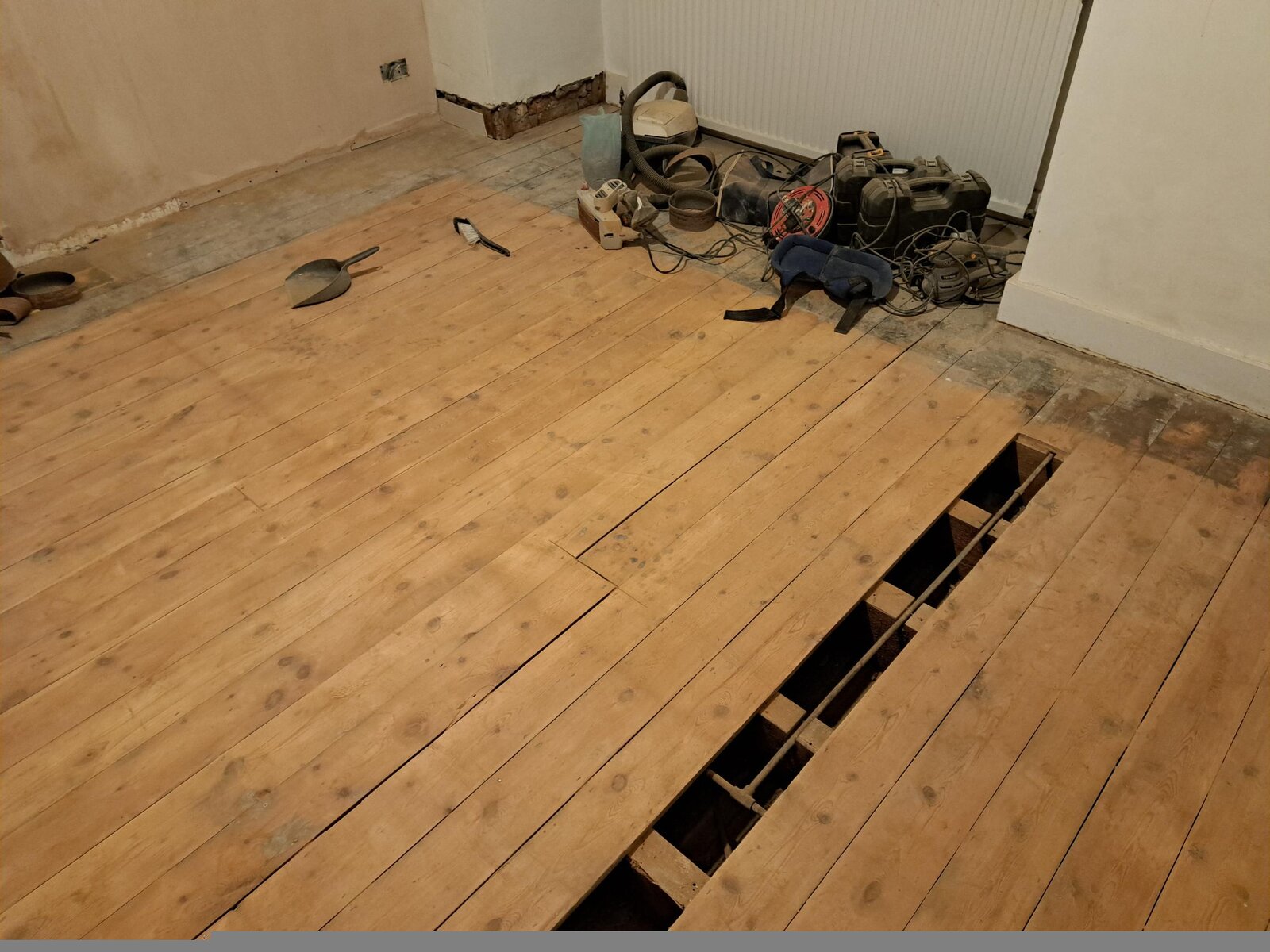

Still not sure what it was but just about got rid of it with a mixture of planing and big bag of sanding belts. Acetone didn't do anything unfortunately.
