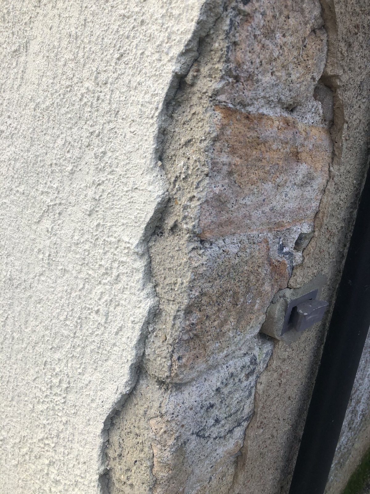

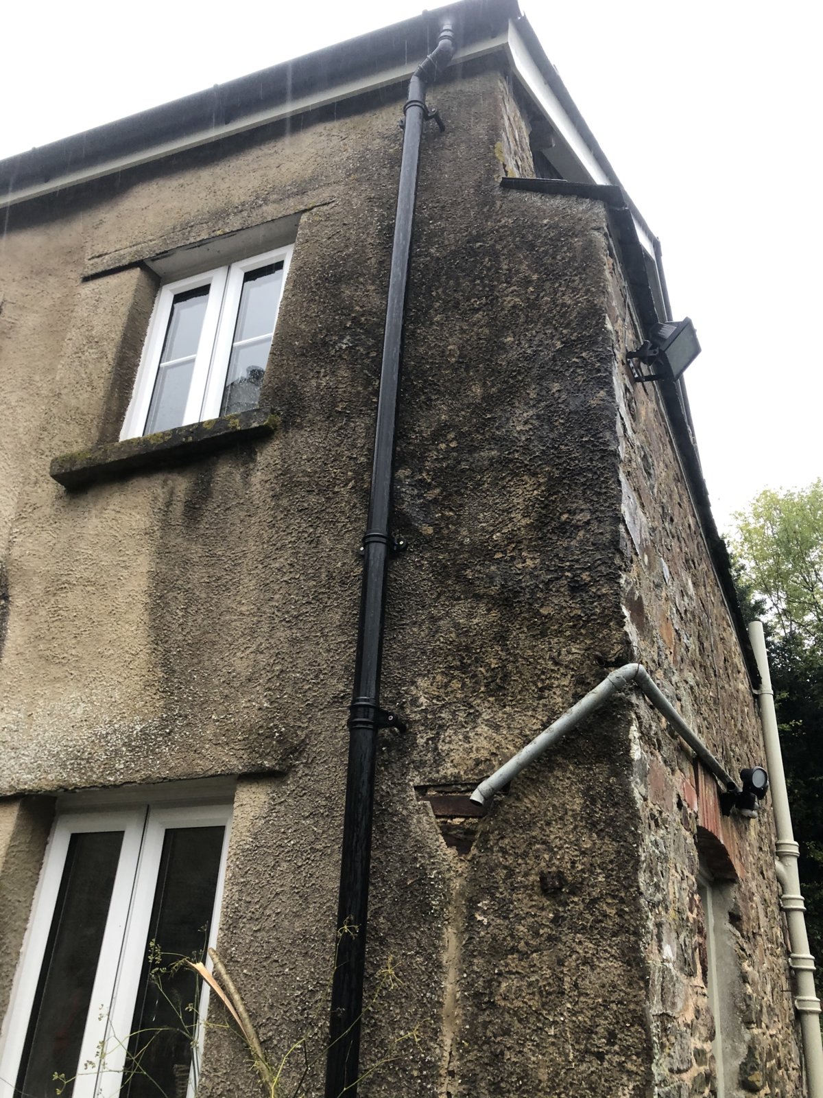

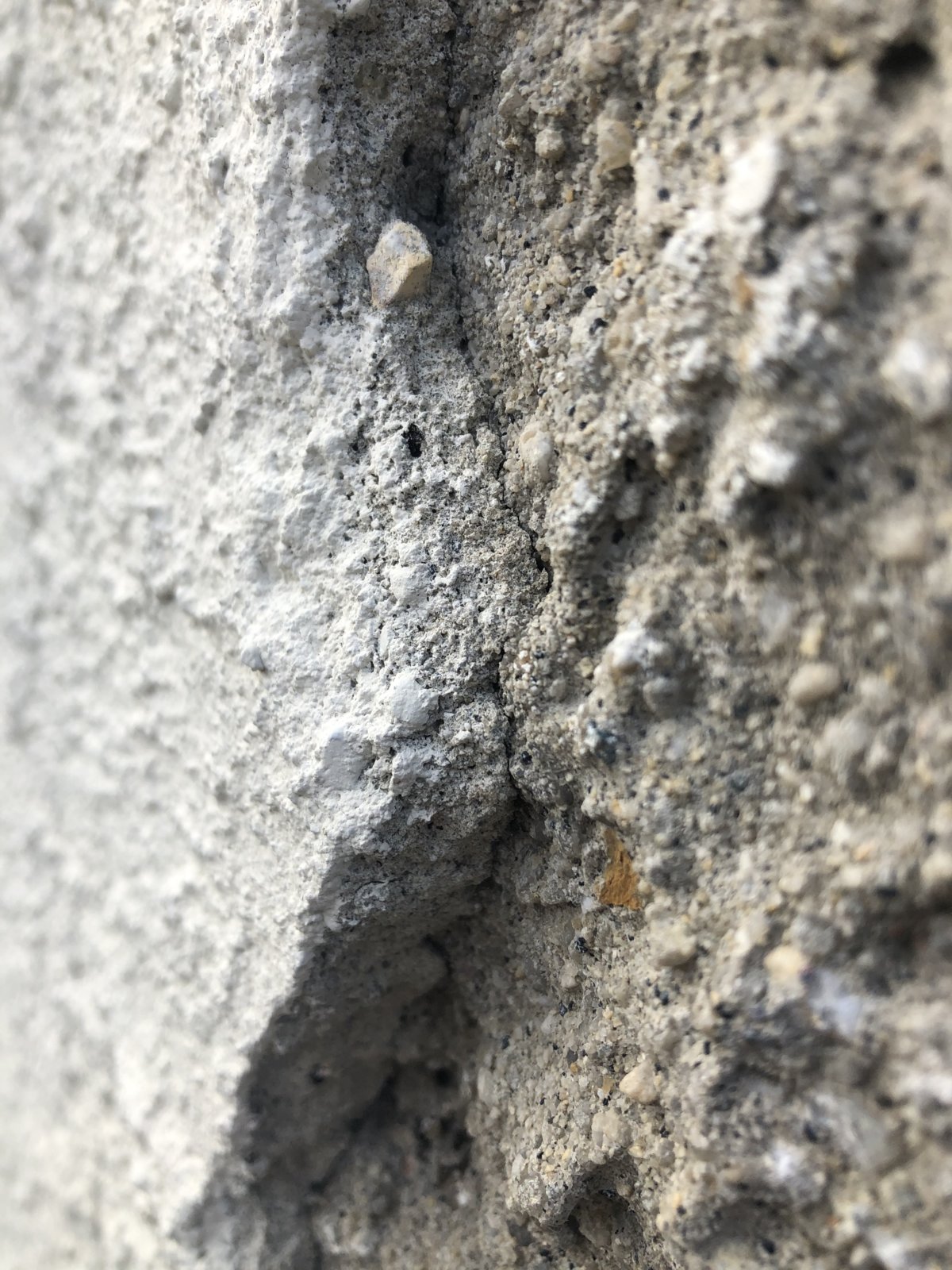

I'm buying an old farm house and have had a chat with the surveyor looking at the property today. He was pretty concerned by the moisture being trapped in the stonework by an old render applied in 1969 (he found datings whilst conducting the survey) and a new render applied by the vendors in 2015. They've applied it over the old render as you can see in the photos. Essentially making the same mistake twice!!
The damp is only showing up in the lintels as they are rotten and need replacing.
I would like to understand what type of render they both are and how to safely remove them without damaging the stone work.
I had a trusted eco builder around the same time as the surveyor as I wanted to see where we can insulate the property. He thought that external fibre board could be installed once the render is off and dried and then apply a lime render on top of the insulation.
My concern is that damp that isn't dried in time could be trapped?
Lastly would the render need to come off in the spring and dry through the summer before adding the new render and possibly the insulation? How long would I need to wait for it to dry out? Bearing in mind there is no damage to internal plaster.
All thoughts welcome! :)

My biggest concern is with externally insulating with wood fibre board a stone wall that could still be damp. From Peter Ward's perspective with stone work this is a big no no.
