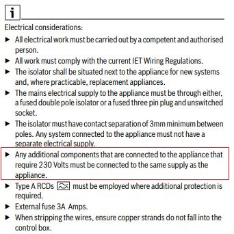

The result is the laws to not actually line up with the regulations. And we do have a problem, under the law I should remove the cover from the electrical connections in a boiler and check them, however some covers on boilers are gas sealed, and should only be removed by some one registered as gas safe, one has to assume if the cover which needs to be removed to check electrical connections is sealed it will be clearly marked as so, however I am told this is not always the case, so the electrician could cause danger in his attempts to remove it, so what ever the law says, he really has to carry on as before and leave the boiler where it is gas powered for the gas safe guy.

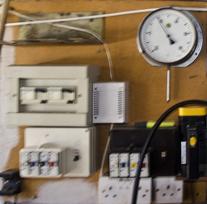

Personally where the premises are used by more than the owner and his family, so the users of the premises may not be of a mental state to under stand dangers be it children or others may use the premises, then the installation should be designed with that in mind, it is all well and good for me to say neither me or my wife will be in danger as we are not daft enough to play with electrics or go around drilling walls etc, but when my son was 14 years old he passed his RAE exam and it was clear to me he would play electrics, so I wanted to protect him, so I installed RCD protection,
however if the property had been rented that option would not have been open to me, only the landlord could have fitted the RCD's, they were not required in the early 90's when they were fitted, but I felt there was a potentially dangerous situation in that my son may play with 230 volt, so I fitted RCD protection.
So we return to the phrase "potentially dangerous" and I felt back in 1990's it was potentially dangerous, so how can I hand on heart say today RCD protection is not required. However when moving in here, it took 4 months before I had a all RCBO board fitted, the 28 days allowed is not really long enough to get some potentially dangerous items corrected, I have still not replaced the steps around the outside of my house, which can get moss on them, or snow, and also be potentially dangerous, does it really matter if the danger is slippery steps, non child proof gate, or rickety garden shed, in most situations we assess the risk, and decide if it needs improving and when, with my garden steps I can use the set other side of house with a hand rail, so feel not urgent to correct, that is my personal opinion, the same as the EICR is the inspectors personal opinion, and it does not really matter if he does not highlight some potentially dangerous items or if he highlights potentially dangerous items which most would accept, it has his personal opinion.
