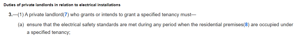

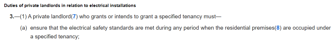

If you intend to live in the property there are none. However only a fool would move in to an unknown building and not have the electrical installation properly inspected and tested. The same for any gas installation, plumbing, heating, changing the locks and the rest.

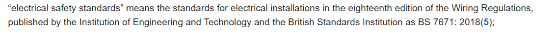

If you intend to rent the property then there are many things which have to be done, one of which is the electrical installation complying with the 18th edition of BS7671.
A rewireable fusebox from half a century ago will not comply with that.
not sure I agree with the property having to comply with the 18th edition - it certainly needs to be inspected to and C3 codes are acceptable for many non compliance
You may not agree with it, but that is what the legislation states.
