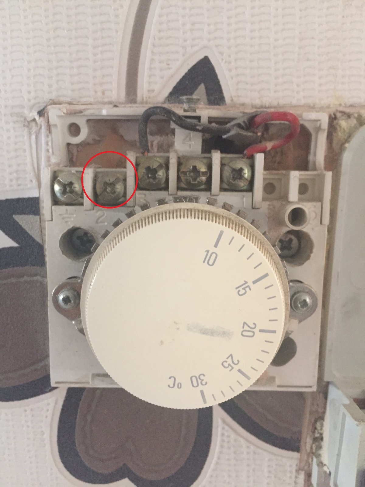

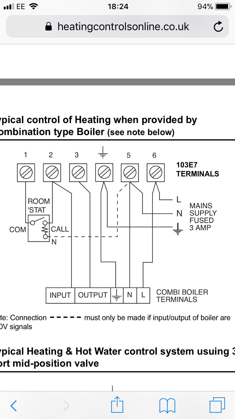

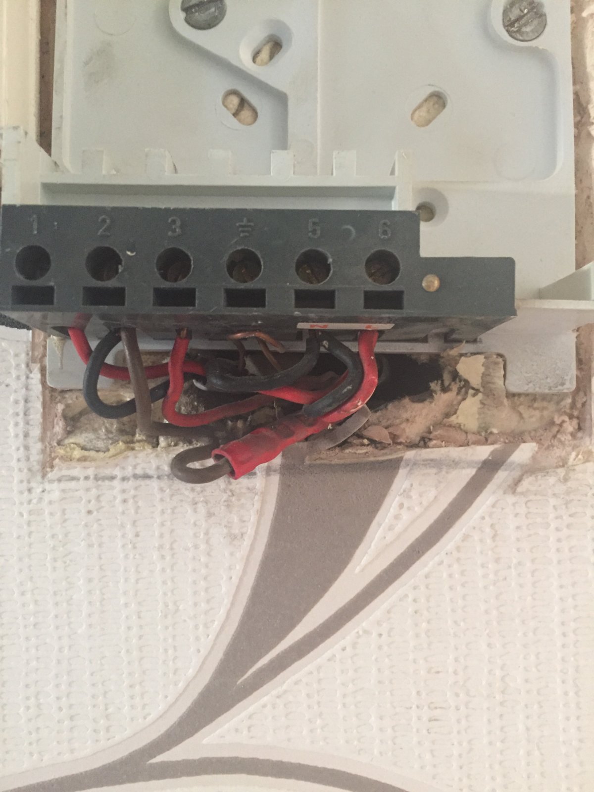

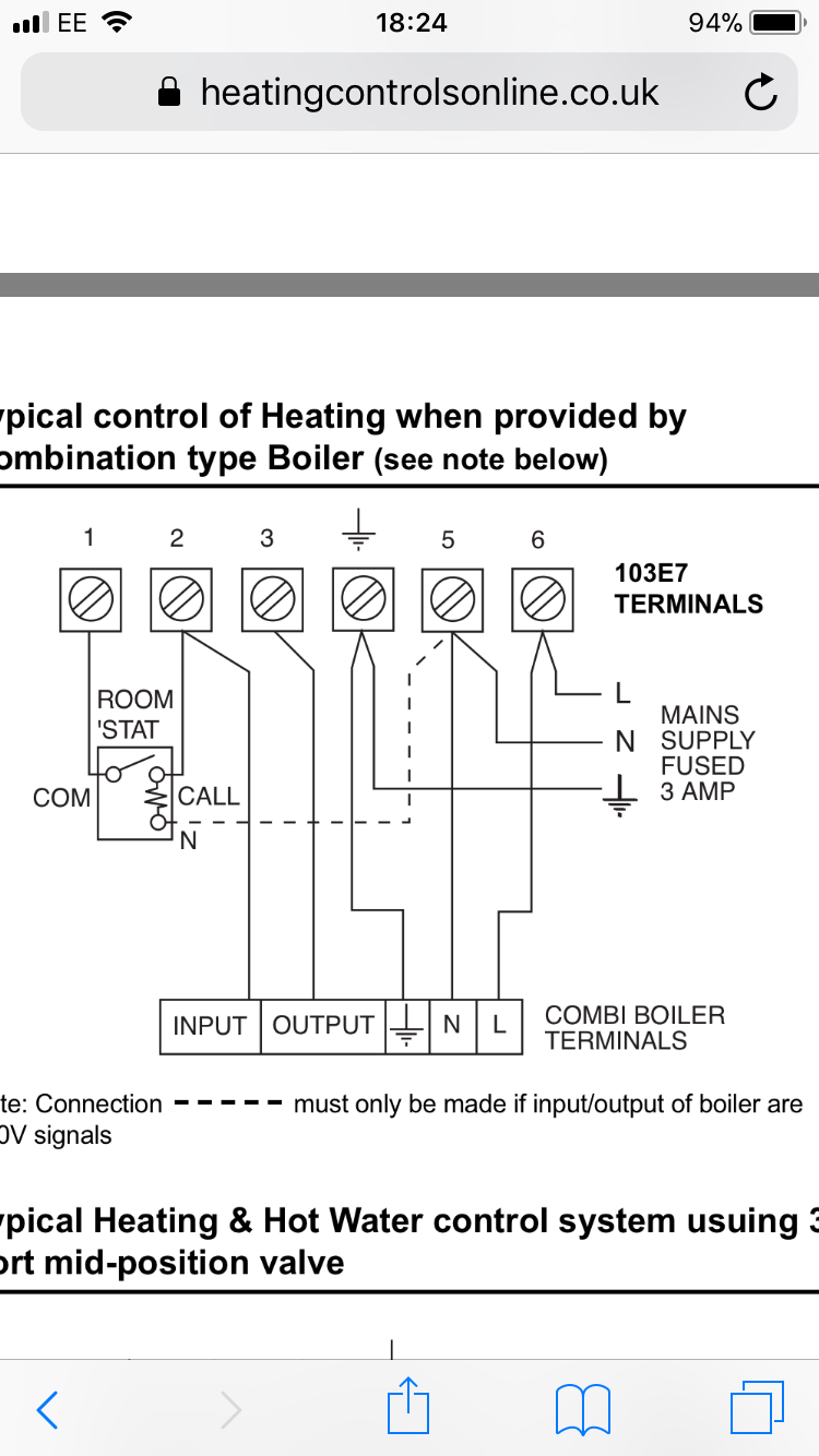

Hi guys, my first post on here and I’m helping somebody can help me to understand the wiring on my thermostat & programmer. I’ve been toying with the idea of getting new and updated programmable thermostat, when I’ve been looking at different ones, it got me curious about the wires that were in my current stat & programmer. The thermostat I understand, it’s just 2 wires which goes into a fuse spur, comes out the other end and goes into terminal 1 & 2 of my Baxi boiler. I understand that makes a circuit when there is demand. I have an old Danfoss Randall 103E programmer, and this is where it’s confusing me. From the fuse spur in the boiler cupboard, I have a cable going into another fuse spur downstairs, then a cable coming out of that into the programmer, so I know that’s my E L N. Then I can’t make heads or tail of the rest of the wiring, there are lots of cables running up the wall and don’t appear upstairs near the boiler, so what would they connect to? I assume they’re all under the floorboards which will be a pig to get to look at. I don’t understand the instructions either. Could anybody with more knowledge than myself be kind enough as to explain to me what does what? It’s been annoying me for 3 days I don’t really need to know because I’d opt for wireless as new, but it’s bugging me!!

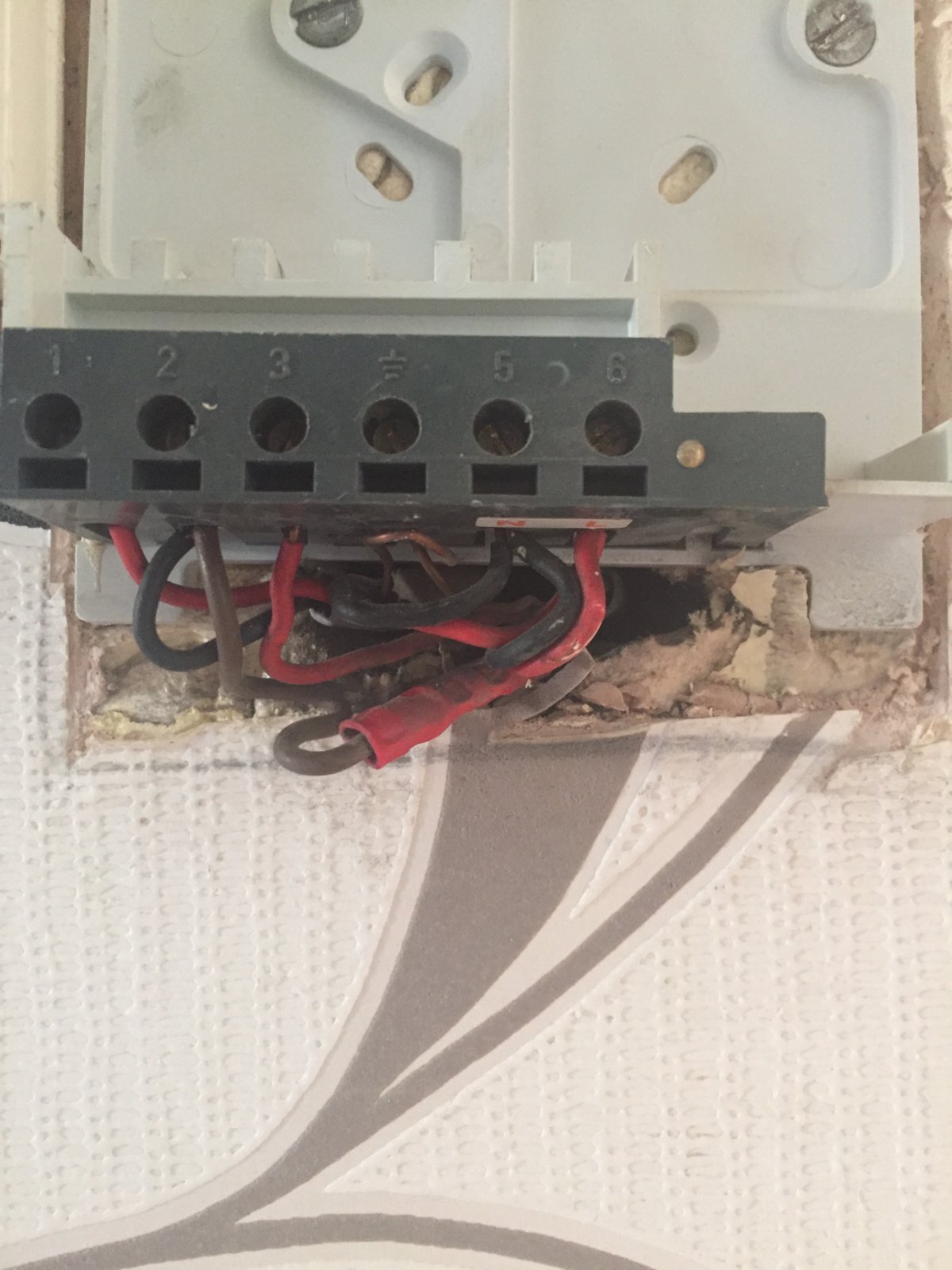

Hi, thanks very much for taking the time to reply.
The boiler is in a cupboard upstairs, I have two thick cables going into the FCU then coming out I have 2 smaller white cables. Which are the L N E for the boiler, and the 2 connections for the Honeywell Thermostat which is downstairs, Then I have 5 of the bigger cables coming downstairs, I’m guessing 2 from the FCU Because one of them connecting straight into the thermostat.
The other one connects into another FCU on the wall behind thermostat and programmer, then I have the other 3 connecting straight into the programmer

Tried to work out what you have, would guess "two thick cables going into the FCU" is the feed to it as part of a ring, but after that can't work it out.

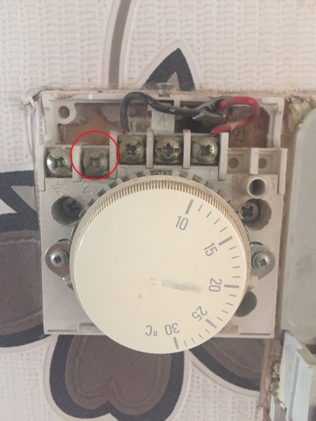

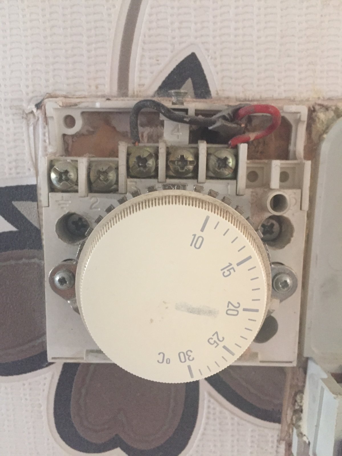

The thermostat is just an on/off switch and yours is wired up using only live wires. The live supply should come in from your Danfoss Randall 103E timeswitch to the thermostat terminal (1) So when the programmer is set to be 'on' terminal (1) of the thermostat will also be 'on' (or live).
If the thermostat has determined that heating is required it will have operated its own internal switch which joins terminals 1 & 3 together. Terminal (3) will now become live, and as it is connected to your heating system, so the heating will operate. When the room temperature reaches the value set on the dial, the switch opens, switches off terminal (3) and the heating along with it.
Unfortunately, your thermostat is not wired in correctly. It is a mechanical thermostat with old technology and by the nature of its design, it is not particularly accurate. To improve things they have a built in device known as an 'accelerator' which is a small heater that encourages it to switch on and off more quickly. However, for this to work it should have a neutral connection to terminal (2). But as you can see in your photo, it is missing.
OK, it will work in a fashion, but it won't be particularly accurate and you will probably notice a change in the room temperature between it switching on and off.

At the moment, you have a separate programmer and thermostat, so if you are going to install a programmable thermostat that has both time and temperature control combined, it will replace both of them, and the wiring would need re-configuring as the 'two' devices become 'one'
There are 5 different wiring configurations for different types of heating system in the 103E instructions. I notice that you have posted the wiring diagram for a 'combi boiler' so assume that is what you have. However, if you have one of the other systems shown ie with stored hot water (a hot water cylinder), and / or motorised valves, more would be involved.
