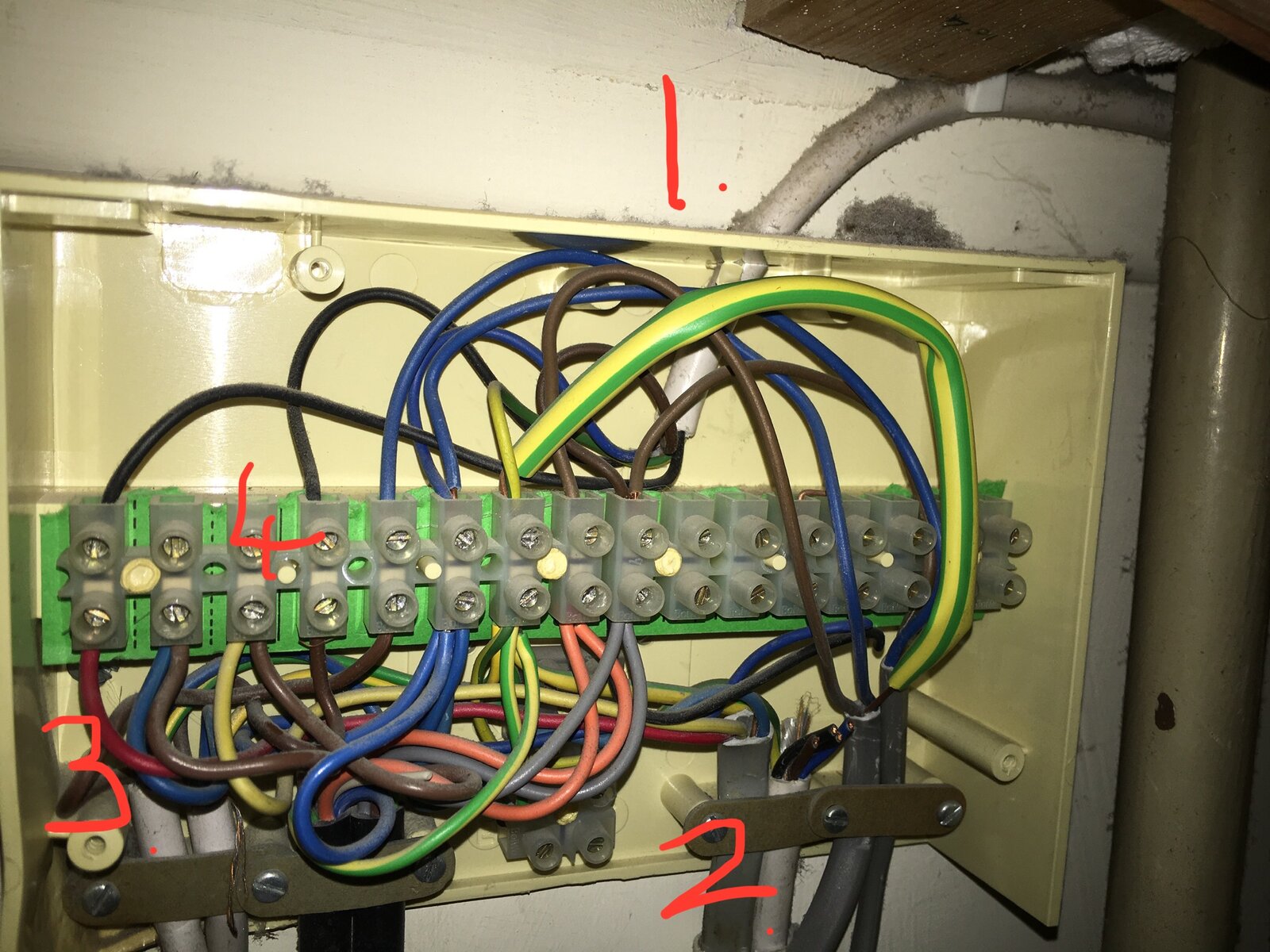

Ok, so I’ve opened the box upstairs where the hot water tank is and this is what I see..apologies for the rubbish mark-up of numbers :
So :
1 - This leads to the Hive unit on the other side of the wall.
2 - I THINK (!) this cable goes down to the original thermostat.
3 - Looks like the red wire on the very left (in position 1 on the ‘junction box’ (not sure what it’s called) is the same red wire coming out of the cable shown by 2.
4 - Looks like the yellow wire goes in here.
I’m mentioning the red and yellow wires as on the old thermostat, these two seemed to be joined together in a small plastic box.
Not at all sure where I’d go from here…?
IF your cable identification is correct then it's a very easy fix- as above, whoever installed your Hive needs a slap as does your 'helper'.
Counting the terminal blocks from the left, you need to identify where the brown core in the bottom of terminal 3 goes. Have you had a look inside the lid of that wiring centre- you may find a circuit diagram

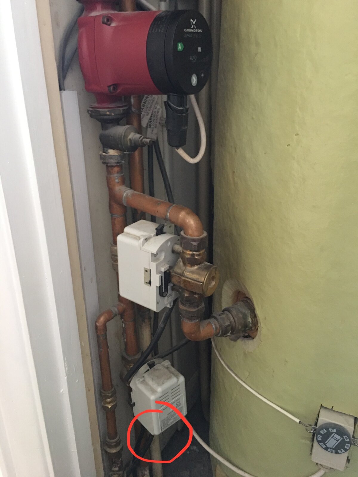

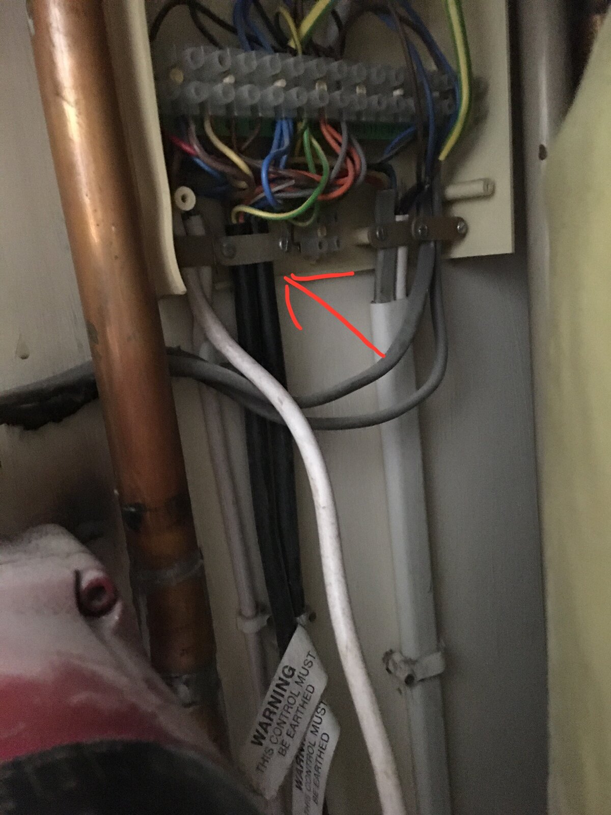

Here are some more pics :
The brown wire goes into the right hand black cable then feeds down and goes into the bottom white valve.
Ok, so far so good. Do you own a multimeter?
And/or can you post a pic of the back of the Hive controller (showing which core is connected to what)
