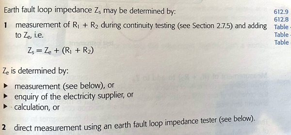

Hmmmm. It seems that my memory was not wrong :) Admittedly my copy of GN3 is quite old (and maybe has subsequentlyt changed??) but, in keeping with my recollection, it says ...
It is perhaps interesting that the first method of determining Zs they mention is not 'by measurement' but, rather, is by calculation as Ze +_ (R1+R2).
Furthermore, although they don't explain what they mean by determination of Ze "by calculation", the only thing I can think of is that they are talking about the 'determination of Ze' by subtraction of (R1+R2) from measured Zs ? If one did that, with the Zs having been measured with main bonds [present (as you suggest), then the calculated Ze would not correspond with the figure you define (without bonds), since it would/could include parallel paths via extraneous-c-ps.

Yes, that is why Ebee said Zs is calculated by adding Ze to R1+R2 - so that any bonding is discounted.
