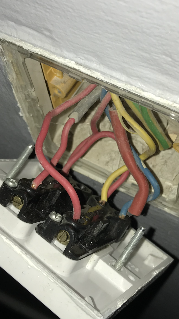

In my hall way I have a 2 gang switch where one controls outside light and the other the hallway light. Hallway light can also be controlled by a separate switch in the hallway too.

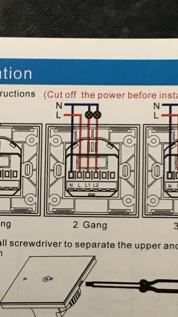

I’m installing a smart switch where I’ve tried once and managed to have it connected and one light the Hallway worked well but the outside didn’t do anything.
I’ve attached a couple of pictures the thicker red wire next to the blue is a black wire with red sleeve.

Looking at picture you have a on/off to left and two way to right, I see no neutral wire on original, the new switch seems to require a neutral, and seems to have no option to use for two way switching.
To get two way switching normally the second switch also needs changing to a slave type switch. There are smart switches which allow a remote which looks like a switch so you get two way switching, there are also versions that work without a neutral.
However if there is no neutral often there is also a minimum bulb size, I know my Energenie will work with 10W but some other makes need 15W, also my Energenie comes as a single switch only so not suitable for you. (It also requires an expensive hub to work with phone.)

Thank you for the reply, the single red wire that comes to the top right com I used as a nuetral on the new switch and it worked fine but I couldn’t figure why the outside light worked.
I think it maybe easier to change the outside light to a smart one instead.
The reason I wanted a smart switch was mainly to control the outside light and like you say it can have timers etc set.
What do you think a light switch does? What is it doing inside when you turn it on?
What do you think would happen if one of the wires connected to it was a neutral?
