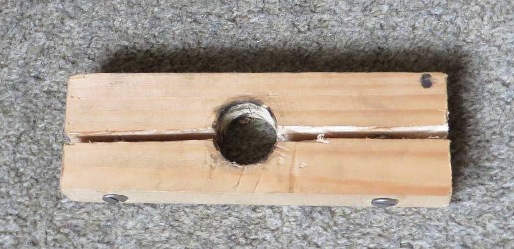

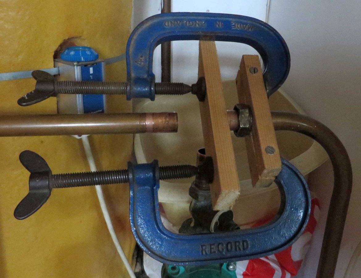

I recently needed to remove three olives from in-situ 22mm pipework. Not wishing to place undue stress on other joints I decided against the 'use a wrench to bash the backing nut' method and being too mean to buy a pukka removal tool I Macgyvered a loosely-fitting pipe 'clamp' from two bits of wood screwed together, placed another bit of wood against the pipe end, then used G-clamps to pull the two bits of wood together :-
That arrangement worked well to shift the olive to the pipe end. One olive could then be slid off by hand, but the other two needed a bit of gentle persuasion with water-pump pliers.

To remove a compression olive; all you need to do is uncompress it, take water pump pliers, slowly & gently crimp it, this will reshape it & enlarge it. It simply moves off the tube then.
On 22mm I waggle them of with water pump pliers, if I'm really desperate I'll go in the van for my olive cutters.
I have an Olive splitter and it is great, a one of purchase at under £20 as long as you keep the apprentice away from it

Fook me a junior hacksaw plus a flatty would have an olive off in seconds
done a 14 rad job all done in Truwell, cust wanted to keep the existing rad valves , would have been a bit of a ball ache without my olive splitter, it has paid for itself many times over
If I can't twist them off then these are next out the bag, not really a diyer's tool tho I guess.
