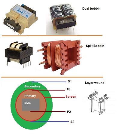

Continuing from last post.
A transformer that is layer wound relies on a few layers of insulating tape. If the Live side of the mains is connected to P1 then capacitive coupling between the windings can lift the S2 side of the ELV up to mains voltage. Enough to cause a tingle from a damp door bell push button
In all cases a failure of the isolation between LV and ELV will connect the ELV circuit to to mains voltage. There will be no Earth current from the now hazardous ELV circuit which means the protective RCD supplying the transformer will not trip.
The mains RCD will not trip with any supply from an isolation transformer. This has been the argument over the use of reduced low voltage, it may mean only 64 volts to earth, but the RCD on the low voltage side of the supply, will not trip.
I read @flameport link, but we are not worried about "Normal conditions" the whole idea is to protect when the conditions are not normal.
The mains RCD protecting the supply to the isolation transformer is likely to trip if the isolaton has failed and the ELV has a connection to Earth.
The mains RCD protecting the supply to the isolation transformer is un-likely to trip if the isolaton has failed and the ELV has no connection to Earth
