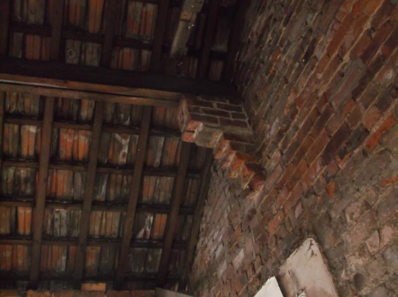

In the roof of the typical Victorian terrace house, the purlin might be supported off a small projecting brick corbel.
This one is the biggest I've seen - ridiculously over-sized, and guaranteed to put an eccentric (and therefore detrimental) load on the gable wall.
