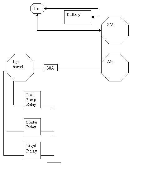

need some thoughts,,,
ref: trike re-wire...
have wired a trike a year ago which seemed fine. will try upload some wiring diagrams... but see what you guys think so far.
ok so its a 12v chassis return.... i have a lead from bat+ to isolator switch - then iso sw to starter motor - then to the alternator - then to the ignition barrel. it is fused on the line between alt and ign barrel.
ign barrel then provides outputs at various stages to
1. fuel pump relay
2. starter motor relay
3. main lights switch relay
4. a few minor things such as fuel guage and horn.
so its not highly loaded at all, its just hold on relays etc.. (the main feed for starter motor and fuel pump etc comes direct from isolator switch.)
problem is it all works and has done, but for some reason the fuse on the line between alt and ign barrell now gets hot and blows as if overloaded???
currently a 30amp fuse which will blow once vehicle has been used for 2 hrs or so.. ???

guys, sorry for poor pic,, but this is the basic cct...
ign barrel is to hold-on contacts on relay,,,, the main power through the top of the relays ie:to the componets comes from Iso (isolator switch)..
obviously everything is earthed appropriately,,,, and there are a few extra things off ign barrel,
the guages, horn, small indictaor dash lights, the small lights for 4 guages and i think the brake switch...

A couple of normal relays shouldn't be drawing anywhere near 30A. Are you absoultely sure they are wired correctly? How big are they and what is the resistance across the relay coils?
The starter motor solenoid will take a few amps but is only a momentary action.
The more conventional setup would have the main fuse as close to the battery as possible (in your case, after the starter motor) and (perhaps more importantly, see below) to run the output from the altenator directly to the battery +ve.
Also, you say the main feed for the fuel pump etc comes from the isolator, it which case, all of that wiring seems to be unfused (unless they are seperately fused??)
Having said that, I can't see why the 30A fuse should blow, you'd still need a sufficiently large current draw, which you don't seem to have. In your boots I'd disconnect the alternator and run the whole thing off the battery for a while, see if it still breaks.
What I suspect is happening to you is that everything you have there which is powered via the ignition switch is running of the unsmoothed output of the altenator - i.e. it's very noisy/spikey - The altenator will be relying on the battery to act like a giant smoothing capacitor. You could be getting pretty big voltage spikes on there (especially when you start or stop the engine) which are overloading the fuse.
b.
Where is the power feeding the auxilliaries controlled by the relays actually supplied from?
Would it be possible that you have one of the relays getting power through
the fuse instead of from the battery circuit. Disconnect pin 30 on each relay
in turn and wait to see if the fuse blows. Pin 30 should be getting power directly from the battery side of the starter solenoid. Eventually you should get one that when disconnected the fuse wont blow, and you have found your problem circuit.
If the fuse keeps blowing with pin 30 disconnected from all the relays, there is a short in one of the relay coil circuits.
When you get your problem sorted you may want to put additional fuses on the supply to pin 30 of each relay as the single fuse you have at the moment wont protect all the wiring.
