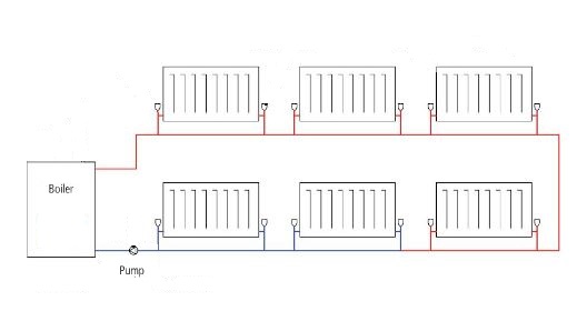

Hi,
We have just moved into a house with a one pipe gravity fed heating system. The boiler is relatively new and works fine, the 5 radiators upstairs all get hot and work fine, but the 4 radiators downstairs only get warm, not enough to heat the downstairs to a decent temperature.
The boiler (Ecotec 428) has been moved into the attic by the previous owners, could this be the cause?
just change it to a standard flow and return system , the 4 series was never designed for a one pipe system, surprised it works at all
Unfortunately, that's the way one pipe systems work. Hot water from the boiler arrives at the first upstairs radiator, where it looses some of its heat, it then passes to the next radiator where it looses a bit more before going to the next and loosing yet more....and it continues, each radiator getting slightly cooler water than the one before. So by the end of the loop much of the heat is lost. The more radiators there are the worse it becomes.

Usually with a properly designed one pipe system the radiators at the end of the loop are larger to take the heat loss into account. Fitting TRV's to the radiators often helps as the upstairs rooms get warmer the TRV's close and allow the hotter water to travel further around the loop.

I have tuned the boiler down to only 13Kw and partially closed the valves on the upstairs radiators, is there anything else i can do in the mean time to improve the heat flow to downstairs?

Even when i turn off all radiators upstairs, the downstairs radiators dont get any hotter? Is this a sign that the pump inst doing its job then? All radiators have been bled.

Test the temperature of the pipes to and from radiators, it should get slightly cooler after each radiator but the by-pass pipe needs to allow water to travel without going through radiator and the inlet needs to be high and outlet low
if a by pass is blocked, turning the radiator off will stop all working. It is thermo syphon through the radiator but not whole system thermo syphon, so lagging the inlet pipe can help with thermo syphon.
